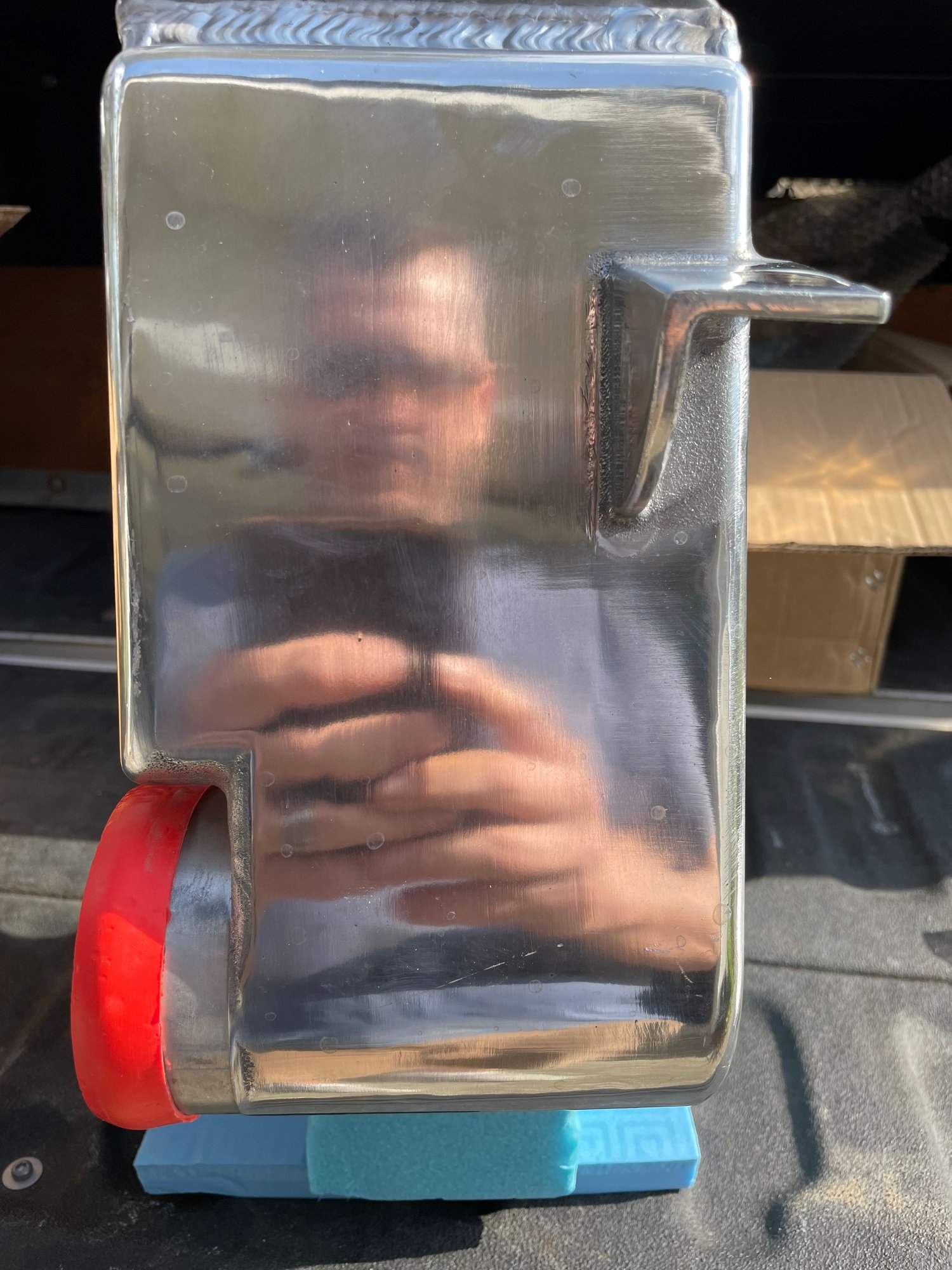

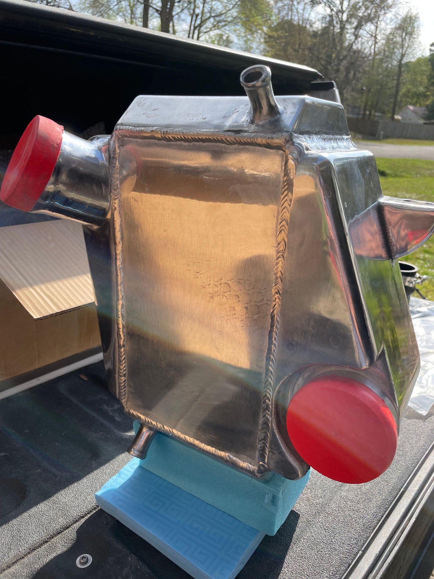

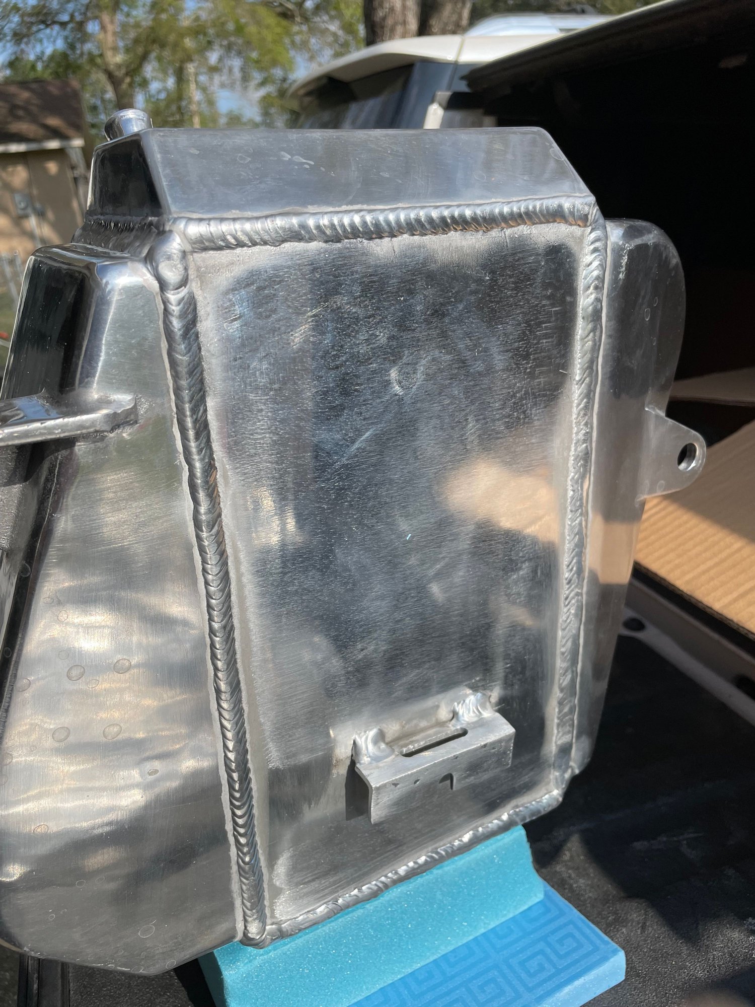

Pro Power Diesel and SWAG look very very similar. I know the Pro Power CAC is heavy. I run Pro Power CAC in my truck along with their full piping kit. The CAC is not hard to install.

My OEM CAC had the lines on the top. Now, the Pro Power CAC ( 17 and up ) one appears to be the same as the SWAG ( 11-16 ). It is a very large CAC upgrade. I drained the main rad about three gallons and then removed the battery and battery box for maximum room to work. That gave me time to clean the battery box and coolant bottle. The 11-16's have a 3" bottom right hose opening. 17-19's reduced the opening to 2.5"s. I bought a new silicon hose that was 3"s to fit the new CAC and piping kit that I use from Pro Power.
