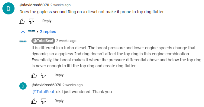

Hmmm.... Interesting discoveries in the YT comment section that I've not heard anywhere else, but it makes sense. When you think about it, the downward pressures alone (not to mention the added benefit of boost) that the diesel engine's top compression rings experience would make it unlikely for the ring to lift during compression. Not to mention this engine will rarely see the high RPMs typically required for the phenomenon to occur.
MAHLE never mentioned anything about this, but how can we expect them to.... They're not in the gapless ring business. At the same time, we can't always believe every claim made by Total Seal (they're trying to sell a product).
Another theory I had is that these could aid in cold-starts. In my mind, the gap is most open when cold, and closes under heat. Therefore, when cold starting without gapless rings, you're trying to compress the air (and heat it ofc) with a greater possibility of compression loss. Especially in an older, more worn engine. It's something to consider, and I reached out to Total Seal with that question.

With my concerns of ring flutter now reduced, I am less hesitant to give it a shot.
If I was building a typical rice burner engine, I couldn't justify spending the extra $100. However, I am building a turbodiesel engine with a HEUI injection system, and that makes it different for me.
