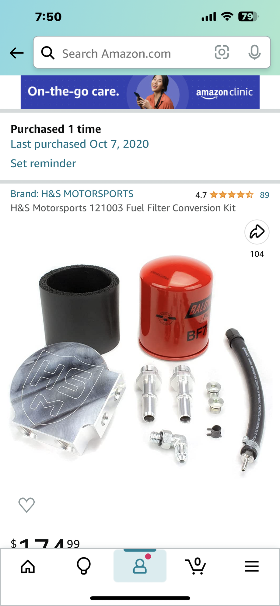

Thanks for the insight Fritz... Ever since my first diesel, new 2004 F350 with the 6.0 - have always been attentive to use of OEM oil/fuel filters. Even with PTT ARod's assessment of the HSM upper/lower fuel filter replacements/updates - still haven't pulled the trigger, "yet". Maybe a leap of faith I need to explore.

double check the micron rating of the to-be filters vs the stock ones.
2017 and later have 2 micron in engine bay filters and 2016 and earlier have 4 micron ones. The ham filters are only 4 micron
You have a source for that info... that the 17 plus engine filters are rated at 2 microns as opposed to 11 to 16s at 4 microns?
Old Jun 25, 2023 | 07:36 PM
speakerfritz's Avatar
speakerfritz
Joined: Jul 2013
Posts: 14,301
Likes: 2,197
im recalling the table top fuel system diagram for the two have different engine bay fuel filter specs.
not to say that if didn’t change later .
let me know if you see the 4 in the 11-16 and the 2 in the 17 and later.
Old Jun 25, 2023 | 08:02 PM
speakerfritz
Joined: Jul 2013
Posts: 14,301
Likes: 2,197
So now I can’t remember where I saw the 2 micron engine bay filter spec.
i found the 2011-2016 diagram and it shows 4 micron
also found the 2020 diagram and it shows 4 micron
so are our engine bay filters really 4 micron?
