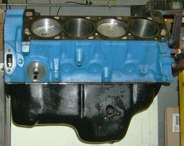

Mine is just not drilled in my '77. I've seen others.
Not my photo, but I think the lighter spot is just light reflection.
I blocked my 2wd block's dip stick hole with a long socket head bolt with a nut inside the block that is staked, then I see the orange RTV on the outside. Projecting the path, a dipstick would hit the oil pan and curve or bend, and never tell you how much oil is in the rear sump where the pickup is.
You can see that the lowest point in front is not much different than where the dip tube ends down in the sump .... 4wd pan on my 400. The tube has a tube nut and actually goes down in the pan, and the stick goes further. If using a front dip stick with a 4x4 pan, even a slight down hill grade would trap oil in front and give erroneous readings.
Now I'm curious. If I took this oil pan and blocked it level, plugged the dipstick hole, and put 6, 7, and 8 quarts of liquid in it, just to measure the levels on the side. I'll have to try that. I think I only have maybe 4 bolts on this one, just snug.

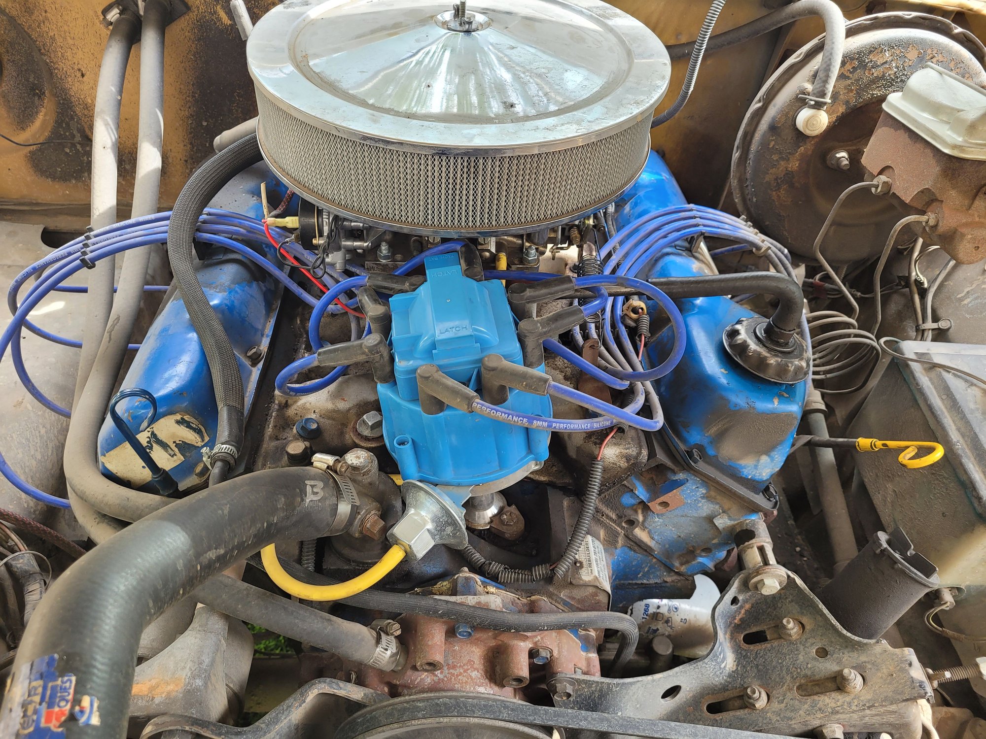

This got me curious. I went out to my rig and checked both dispsticks. Here's the part numbers on them. My engine has a rebuild tag from the '90s. Going off the dipstick numbers it looks like maybe the block came from a car and then they put the 4x4 pan on it. Interestingly the front/passenger side dipstick is quite a bit shorter than the mid/driver side dipstick. They read different too. The driver side (4x4 going from @tbear853 's pictures) Shows about half a quart over the high mark for me right now, and the passenger side dipstick shows about half a quart low.
