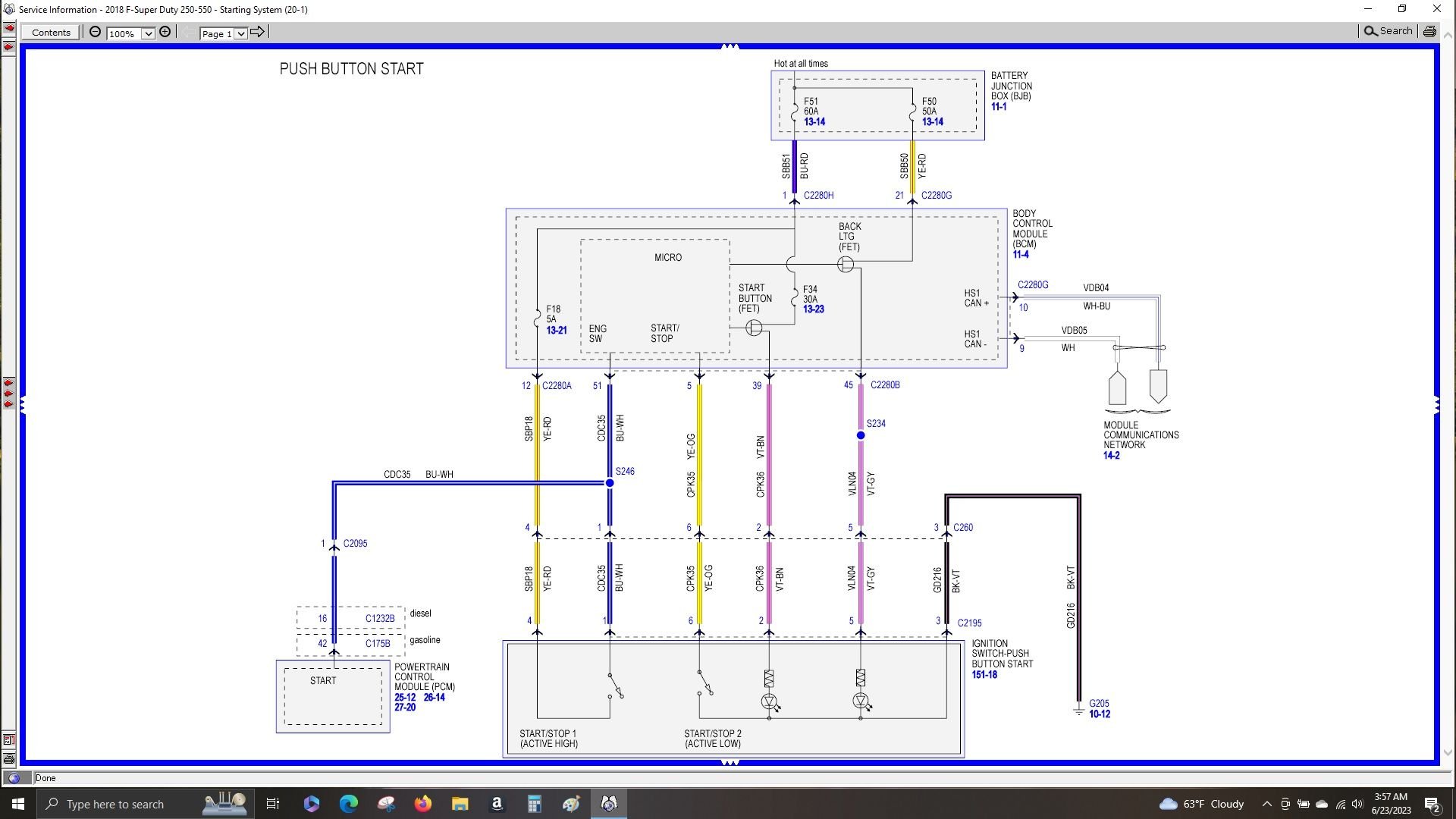

Any one have a wiring diagram for the push to start/stop button?

Dual batteries is a little different. This is for a single battery:

Thank you taking the time to post this for me... perfect!
