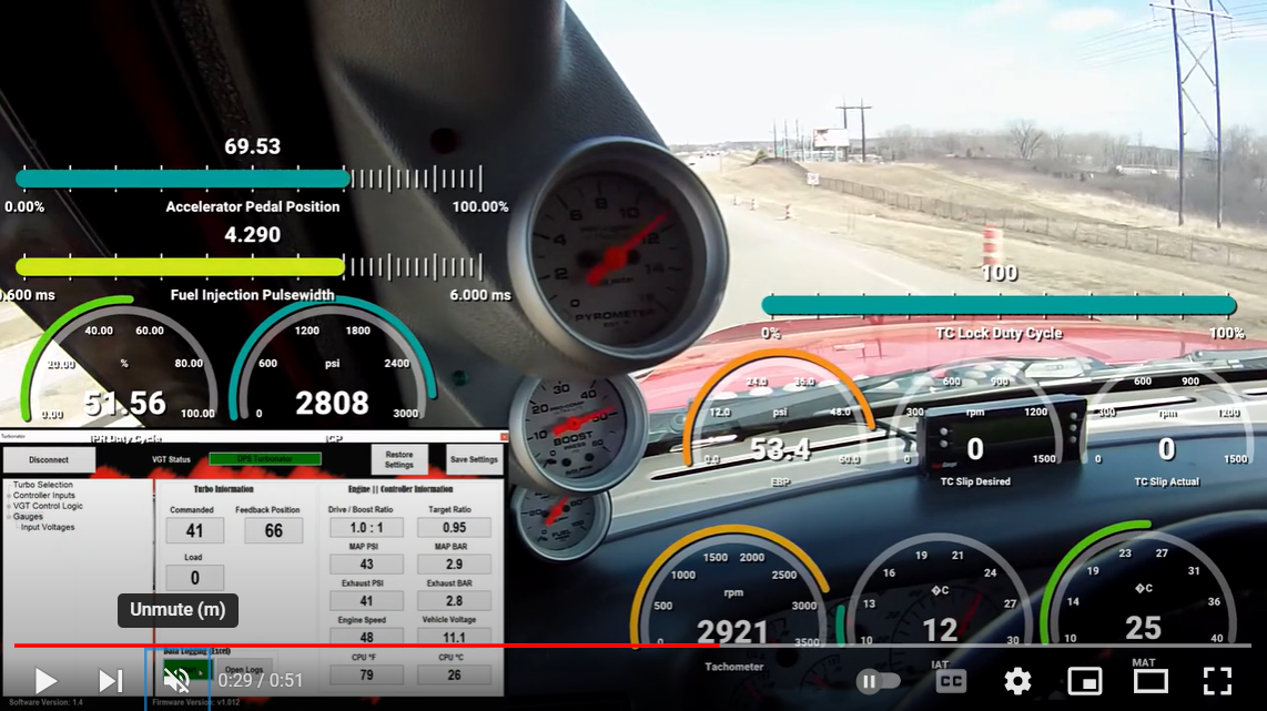

@FordTruckNoob , are you able to provide David with any advice on torque converter PID's he should be loading to FSL? I recently saw in one of your videos that you had TC_SLIPACT and TC Duty Cycle.
Snip from video is below.
