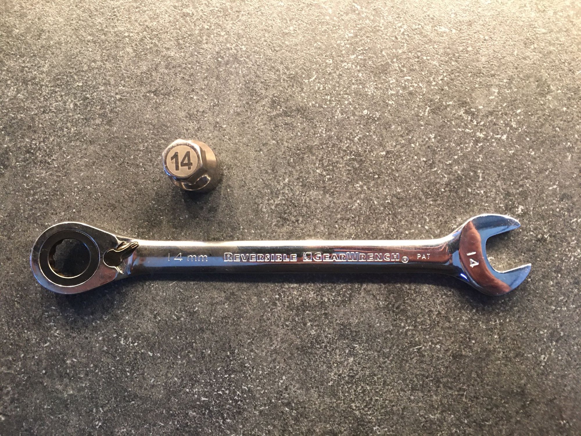

And I went out to the carport, it's shaded ... but there's no breeze in there... Used a 8 or 9 inch long 9/16" combination wrench as I still couldn't get a socket on it. Used the boxed end to break it loose, then knowing about where it was, was able to take the bolt out until it fell, about 1-1/2 flat each time flipping the wrench each time, placing the open end strictly by feel, it fell loose after about 10 hot minutes. Wrench was one of my Father in Law's, I know it's late '60s era chrome "Snap-On". He did add his initials to it.
It's off now, in the basement, on my bench. I'll clean it up, pour out the mineral oil that's in it, change the shaft seal, refill it with 10 oz. ester oil and then "get on with it".
I did double wrap the open hose ends under the hood, and zip ties seal spiders and other things out. An old "Flexicuff" holds it all near the master cylinder.
When I put it back, I'll save mounting the pulley with bearing until after I have the bolts in. If that don't work, it might not get used. There are 5 others.
