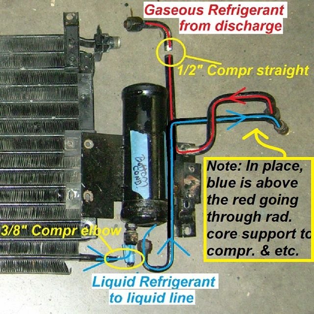

Today ... (well, was the 9th) was working to remove the receiver / drier and condenser to flash,and replace the drier. Lower inlet or as liquified refrigerant exits from the condenser broke off, so that's FUBAR-ed .... then I found a crack in the large suction hose from the evaporator. I could not get the fitting loose above the R-D either, so I cut that (tube that the fat discharge hose connects to) tube in a straight section to get it all out. Bottom of R-D is rusty, and I tried with two wrenches and still never got the actual fittings loose. My plan today was put the compressor back on as well as the R-D and exp valve, thought might even get to charging it ... but not gonna happen any time soon now. Looks like I will need hoses ... and a condenser too now. . For a while I was some little bit "miffed" about it ... like I was somehow at fault, like I shouldn't have even messed with them, but then I realized that they had to come apart to come out for replacement & flush ... and that I had already accepted a delay. I'm sure I'll have easier progress with new hose and tubes and condenser. I tried with two 8+" long wrenches on those fitting nuts, they are still frozen solid.

Went for a walk this afternoon, it occurred to me ... now I have never used brass compression fittings on brake tube, I just always replaced the tube. Brakes use much higher pressures than AC. I spent some time with my condenser, finaly got the top 1/2" fitting loose with a pair of wrenches that fit the fixed large fitting on the condenser top and the short piece of tub there with a tube nut, no damage. I kept the piece I cut off, it goes through the core support and a hose from the compressor discarge attaches there. Where I cut that one with tube cutter is in a straight ... so a 1/2" straight compression type tube coupling will do nicely there ... that metal line may is in the hose kit too though..
The part that twisted off is in the bend of the lower condenser fitting where condensed refrigerant fluid comes out to go to the rcvr-drier. There is enough to get away from the bend where it gave away, a 3/8" elbow compression type tube coupling will allow me to re-use the broken free section to go into the rcvr-drier.
The condenser does hold tight once the two lines are plugged. I have a "fin comb". Looks to me like it'll work, a little paint, done! So now, I just need the hose kit.
The way I laid them out has the red and blue crossing, but in reality it just looks that way because of how I have the blue too low and the red too high coming through the core support. Mounted in place, the blue liquid line will be higher, above the then lower red gaseous line. One of the lower fittings in the R-D was twisted out.

Like ... I was gonna re-use my hoses, but eventually that would have backfired on me I think. If I can save and thus flush the evaporator, I'll likely go ahead with it yet. Likely those nuts will come loose with not being out in weather all these years back next to the firewall. I'll even make some longer better fitting wrenches with "reach" if need be.
