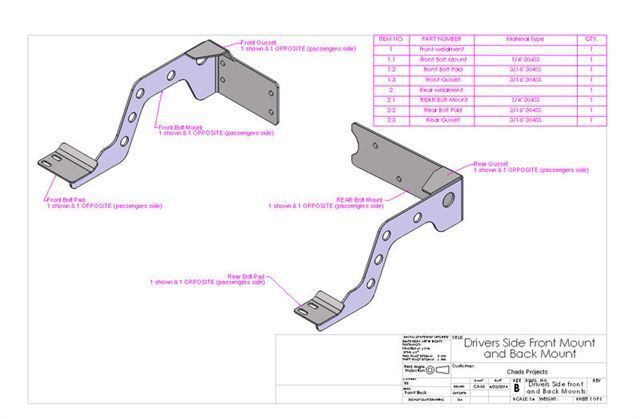

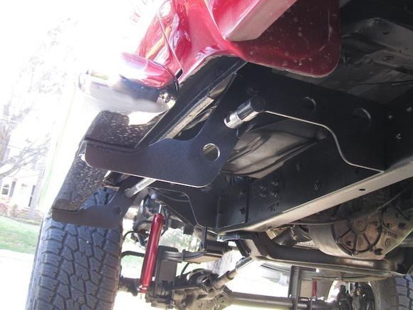

And the brackets the one guy used to mount the newer nerf/tube style steps on his truck. Pay NO mind to the front blocks on his front axle.
