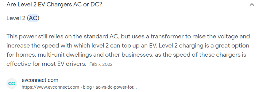

It appears that Level 2 chargers are the following...
