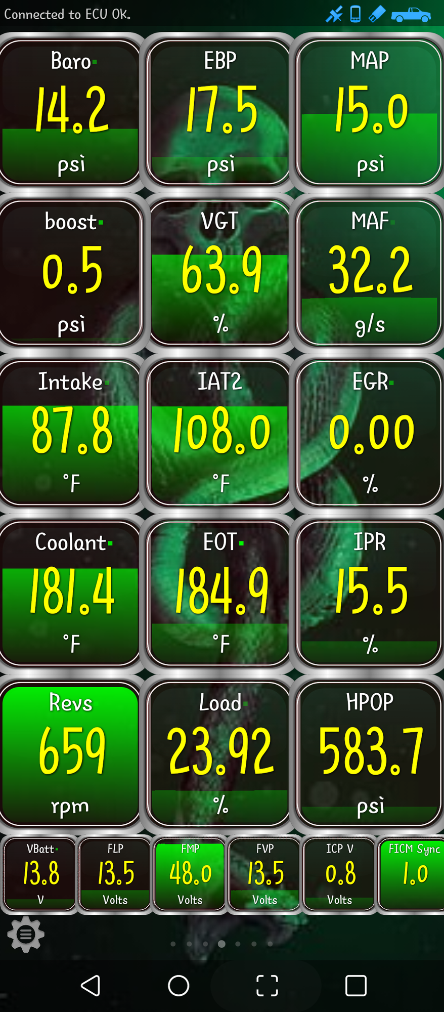

Unplugged ebp i get no boost hot or cold. This is a picture of the latest drive
No amount of throttle could raise boost

I think your turbo vanes are probably stuck.

This is a snap of it idling in the driveway after the previous post
