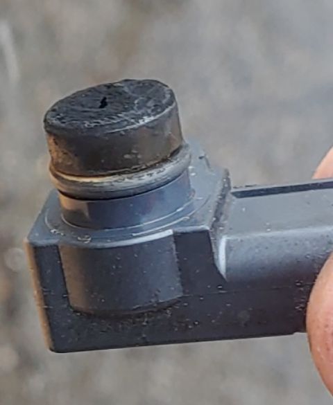

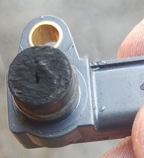

Changed the MAP sensor today
"I have become convinced that fully 97% of the Ford technician training program is centered around how to disconnect all the stupid clips and clamps used on these trucks. I don't believe I've seen any two electrical connections that work the same.
Anyway, rather than cleaning the old sensor, I simply ordered a new one with the idea that I will clean the old one at some point and then swap them back and forth every 100,000 miles or so in the future.
When I pulled this one out, I was expecting dirty, but got a bit of a surprise:
Most of the soot got wiped off while I struggled with that infuriating clip. I'm still not sure how I got it apart!
Anyway, thought I'd share since this exercise was prompted by some of the recent threads here.

I'm going to do a cleaning this weekend on the sensor. Yours looks moist compared to the one I've seen posted.
I'm thinking it's because my CCV was clogged up.

That’s not a MAP sensor…it’s a soot collector.
soot is introduced from CCV system.
SB make a MAP spacer that in theory moves the MAP sensor out of the path of the soot oil spray. I install an SB space a few thousand miles ago and an interested to see if it really works.
another thing I did was install a amsoil bypass filter to remove larger than 2 micron particles from the oil. I’m hoping with less soot particles in the oil…the oil spray whiny carry as much heavier larger particles that collect everywhere along the pathway of your intake. Once I do an official intake cleaning using a diesel intake cleaning product…I can revisit to see if this by pass filter helped at all.
I kept my old map sensor and ultrasound cleaned it with official ultrasound cleaning solution and let it sit out to dry. So I have a spare in case the installed one needs to be cleaned.

I've seen that spacer advertised and thought about getting one myself, but ultimately decided against it. On the one hand I can see how it could work, but on the other it seems to me it would clog up the same as my sensor has. I'm thinking the only real solution is to clean the existing sensor every 50 to 100 thousand miles.
I plan on cleaning this one and keeping it as a spare, too.

Just did it, 10 minutes maybe.
Before photo some carbon build up. Scraped lightly with knife, sprayed with cleaner while holding it upside down so fluid would run out. Wiped outside with paper towel, after photo nice and clean. Reinstalled. 60k miles on truck.

The hole wasn't blocked at all just build up on the top area. Not moist at all either, completely dry. The carbon easily flaked off with the knife. Gave it a couple good sprays, wiped the dirt off the outside plastic.
Good observation... I've removed mine twice and both times it was dry.
