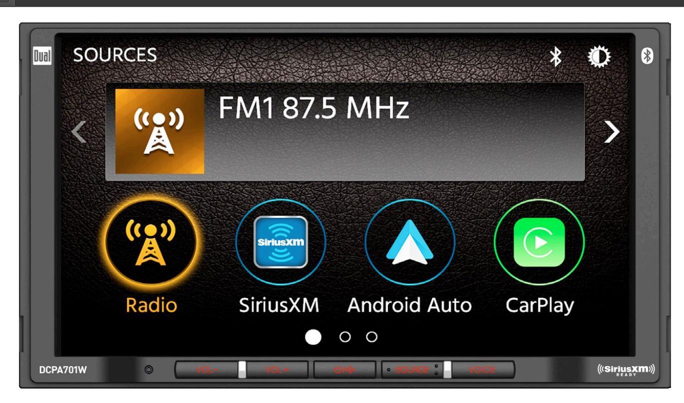

my truck came with this one
it seems to work okay,
typical of most, you plug a USB cord into the phone's C connector, and then the radio sees that, and displays your phone's Apps on the screen.
the AM/FM does what most do, fizzes out when you drive out of range.
I use the Spotify or iHeart apps on the cellphone to get music that never quits while driving, one hell of a lot cheaper than Sirrus

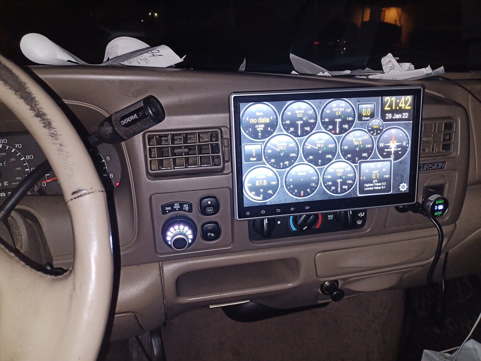

So that is actually just Android Auto, i think he means a head unit that actually runs Android so you can load apps, software, etc onto it directly, with no need for a phone or tablet to be involved.
Xtrons makes some good ones, and for the excursion or F250s the 10 inch double din fits perfectly without blocking the A/C controls, or the vents.
Just make sure to get the ones with 4 GB RAM or more, or they are a bit slow, the 4GB I have is decently fast, and i actually installed a USB connected OBDLink EX+ for using the Torque Pro app, and i added a 4G modem to mine as well so it has its own data connection.
I also attached a 256 GB USB SSD to the back of it to store music, movies, etc. They have 3-4 USB ports depending on the model, and as you can see on my dash, the Blue USB ports go to the back of the unit, so i can plug things in and out without having to dig in the dash.

Your screen is way to big for my pleasure.
and, since I have a CTS-3, those monitor functions are not needed.
agree, that IF, he wants a unit that runs Android, mine is not it.
it is a receiver with a USB cord to enable the Android or iPhone to work with it
mine is obsolete today already anyway, just got off the phone with Crutchfield looking for an install kit, that radio is not in their Inventory

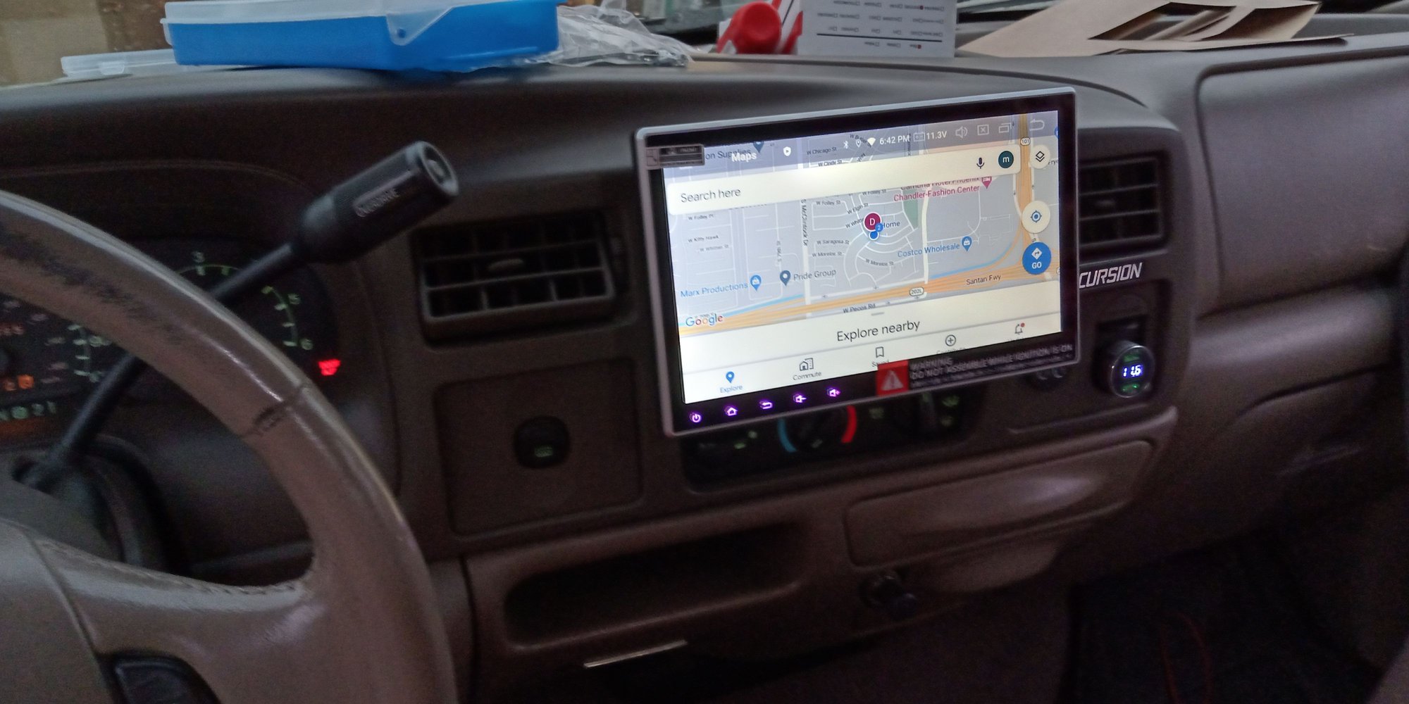

Here is the one i would recommend, its the newer version of mine, and you can rotate the screen vertical or horizontal to fit your preference, its just the newer version of mine.
https://xtrons.com/universal-double-...al-4g-tix125ls

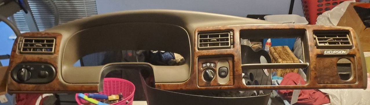

I just today,
getting ready to move my existing 7" Dual flat screen radio from the old broken dash over to a "brand new" looking Eddie Bauer dash.
If I continue to install the Dual in the dash, will this Xtrons unit fit the same opening?
the bottom edge of the opening has to be trimmed down about a 1/4 inch to get the Dual to fit.
my new dash, hate to cover it up.

Thanks for sharing the link. I like that its rotatable.
On your unit, where you able to adjust the height of the screen? If I get the rotatable, I would probably use it more in the vertical position, but will want to adjust the height so the bottom of the screen is aligned with the bottom of the double din opening.

I didnt have to trim the bottom, i did dremel a 1/8 or 1/4 inch off the lip above the radio opening, but that is pretty much invisible, its because fords radio size is a few milimeters shorter vertically than standard double din, but if you have a small dremel, its easy work.
My radio is the model from a year or two ago, it looks pretty much identical but mine does not rotate vertical, only the newer version does, mine just tilts around.
One little tip, don't lock the radio into place when you first push it in, slide it in but leave it unlocked, because twice i had to tighten connections, or decided to change something i had connected to it. I actually never put the locking plate on mine, i just dremeled the upper lip just enough that it fits really tightly, and that holds it in sufficiently, but makes it easy to pull out if i need change something.
Most of the mounting kits, Metra, Etc, once you lock it in, it is a PITA to get it back out again...
