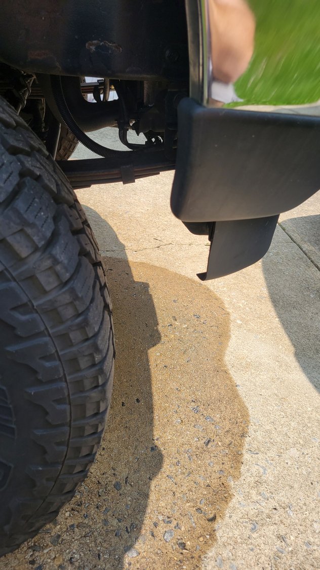

So my 1 year and 7month 3day old denso radiator from rock auto decided to start leaking at the bottom plastic crimp some time last night. Denson only give 12months warranty so I'm out the 180 dollars. SO do I spend 215.00 for another denso from rock auto or spend almost 600 from my local ford dealer?
original ford went 190xxx miles, I now have 192xxx so the denso did not last at all!

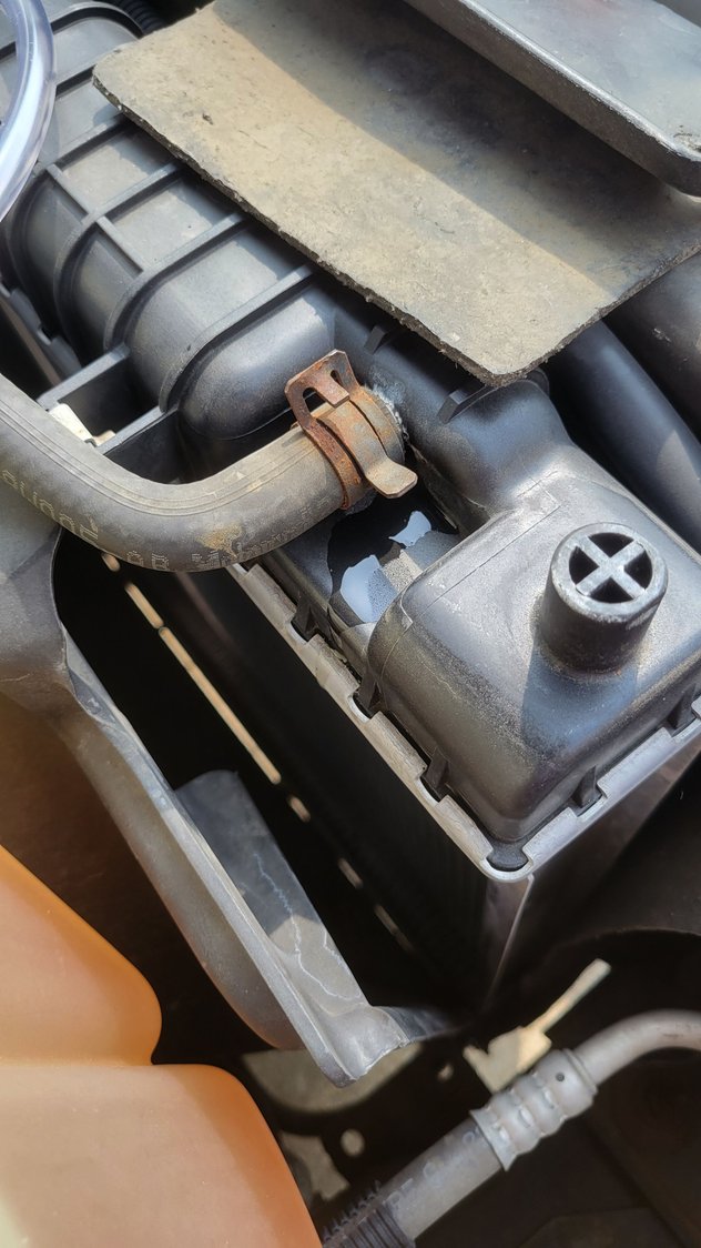

So in preparation for a new radiator, I did some diagnostics. Turns out the overflow bottles crossover tubes constant tension clamp has failed after 191k. At 8psi with a tester hooked up it started leaking, then at 12psi its a nice steady stream. Pulling on the hose it slipped right off even with the clamp still on! Now to see if the dealer has new clamps or not?
