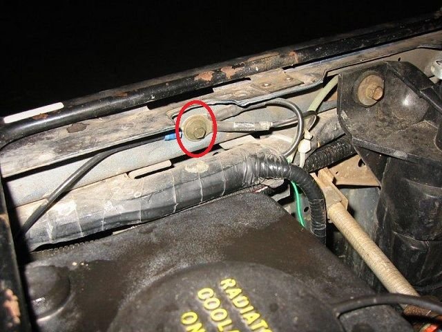

Old May 12, 2023 | 03:15 PM
sandymane's Avatar
sandymane
Joined: Oct 2016
Posts: 6,185
Likes: 633
From: Houston/Sugar Land
This picture is the driver side headlight ground and there is another on the passenger side.
