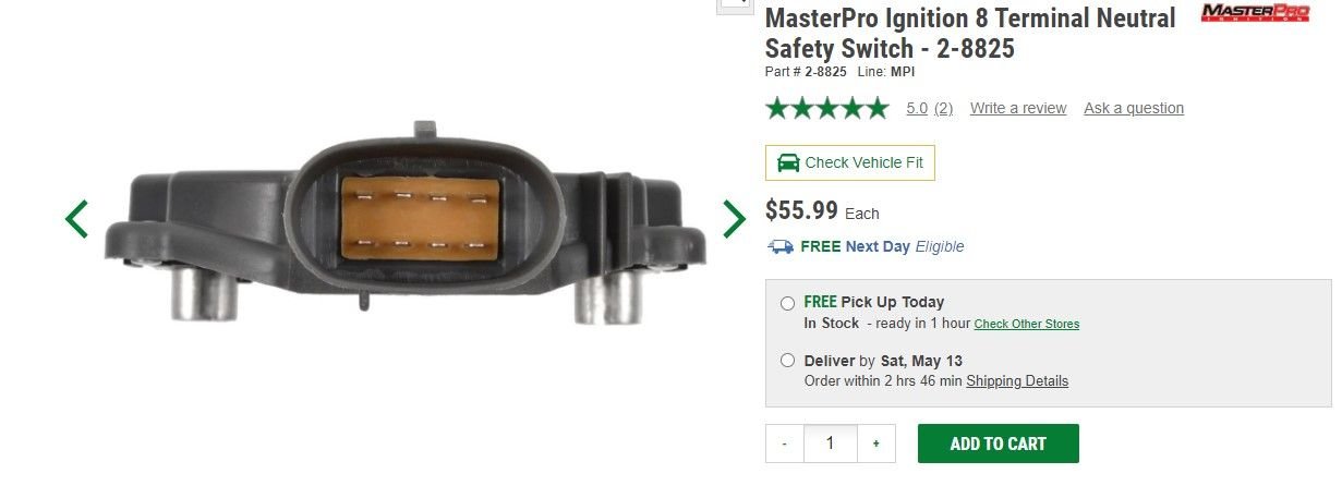

Looking at subfords first attachment, my harness connector looks like the one he says is the new one in his picture. 8 pins.

Here is a picture of the MLPS and the pins from O'Riley that indicates it fits my 95. The picture of the Harness is 8 Pins and it looks identical to the one on the truck. It says it comes with a harness but I am not sure I need it since the pins looks like plug and play. What do you think?

I went to O'Riley and bought a MLPS with the connection at 12:00. It had a harness connector but I didn't need it as the MLPS hooked right up with the 8 pin connectors for a plug and play. KOEO and KOER codes are all clear and the truck is running and shifting better. Thanks for all trying to help.
