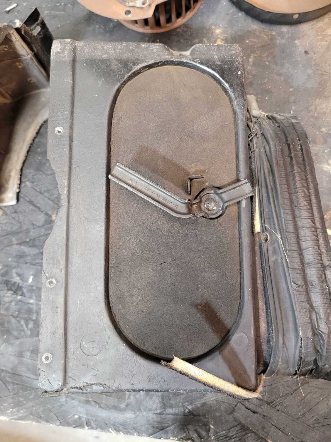

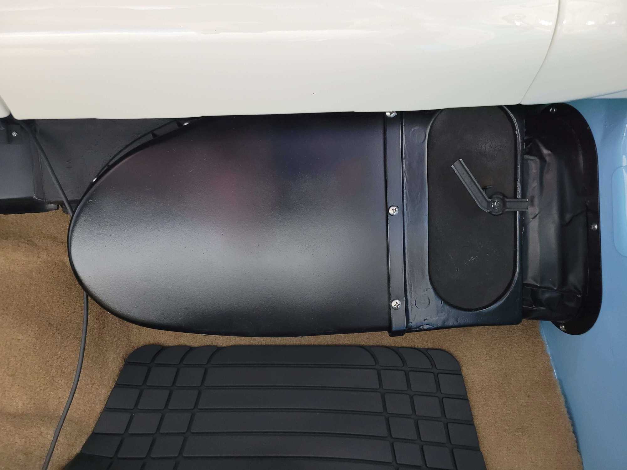

Looking for some help on this heater box from my '62 F100.
What goes in the gap between the heater box and the kick panel opening?
And does anyone know of a source for heater box parts? Salvage yards have been a bust, heater boxed are either gone or in worse condition.
1961/64 F100/1100 & 1963/64 N/NT500/1100 with fresh air heater
C1TZ-18B259-A .. Fresh Air Heater Duct Assembly / Includes C1TZ-18A594-A Fresh Air Connector (flexible duct) / Obsolete
CARPENTER NOS PARTS in Concord NC has 1 = 800-476-9653.
OBSOLETE RELIABLE PARTS in Nashville GA has 1 = 229-686-5101.
C1TZ-18A594-A .. Fresh Air Heater Duct Connector (flexible duct) / Obsolete
KLIMESH MOTOR SALES in Calmar IA has 1 = 563-562-3241.

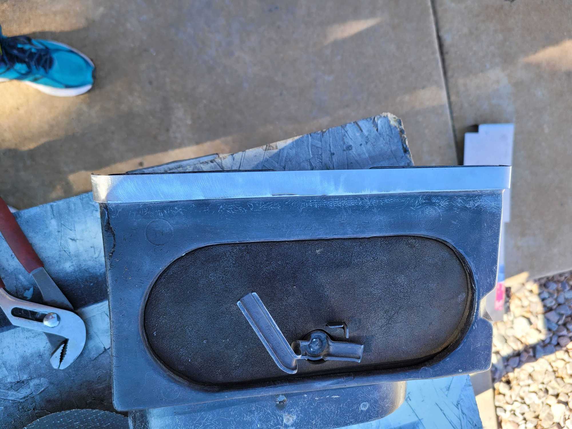

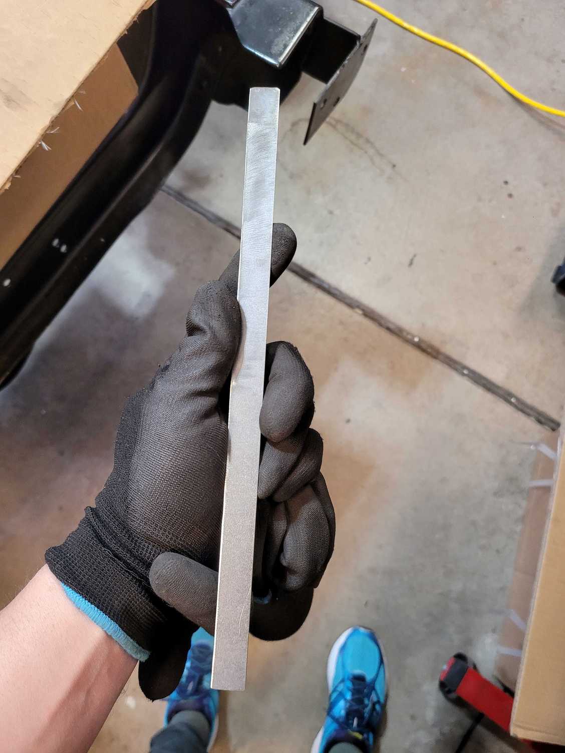

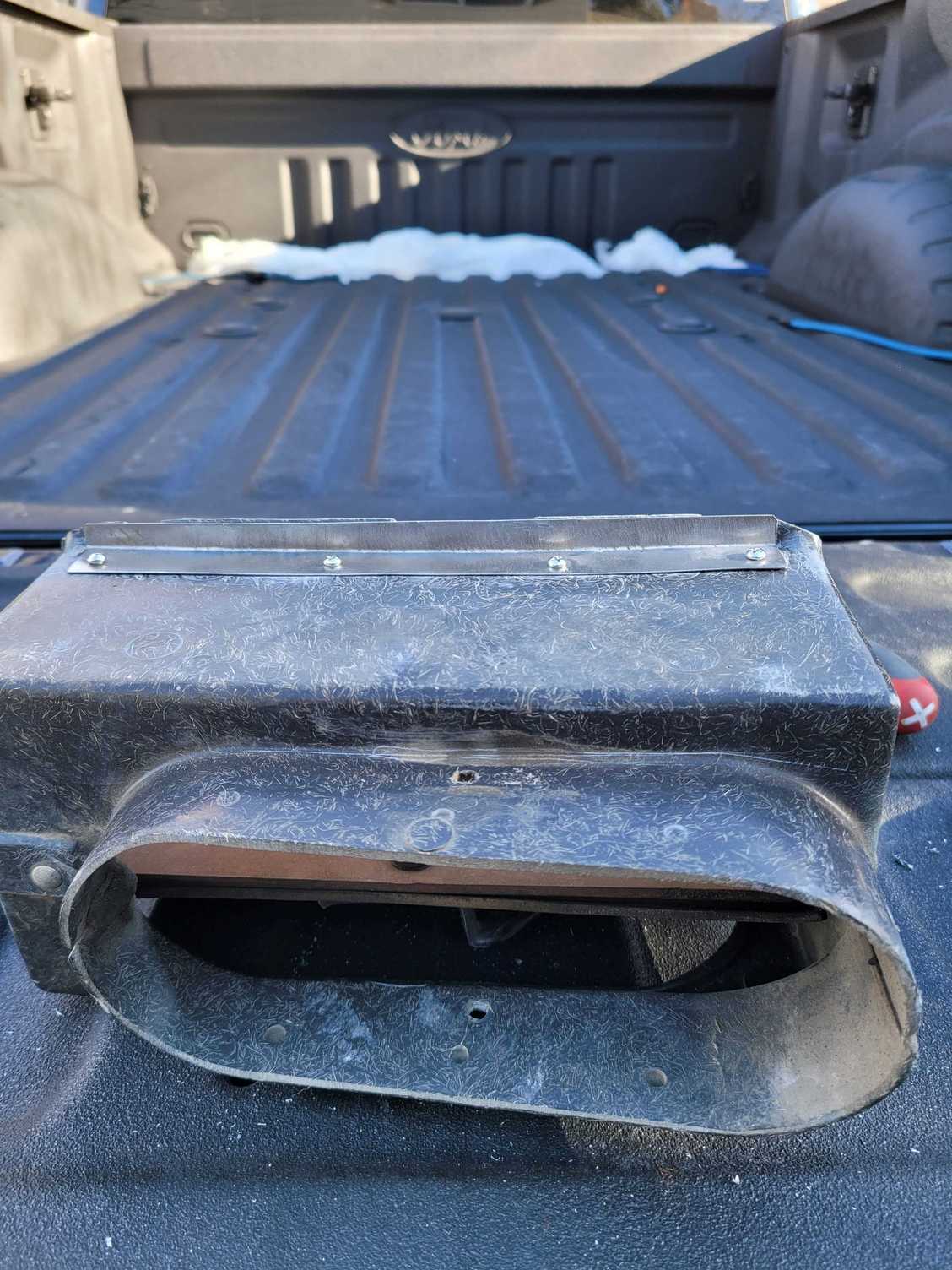

Thought I'd share this with you in the event you're unable to locate these.
16g 3/4" strip to reinforce the duct assembly.
I wish I had photos, but I purchased a $30 fiberglass repair kit on Amazon to fix the cracks and fill the gaps.
Reinforced the back.
Used Gorilla tape around the frame of the duct connector.
This isn't for everyone, but if this helps, awesome.
Super helpful - thanks a bunch!!
Replacement parts are nowhere to be found, looks like I'll be removing and repairing similar to your process...
