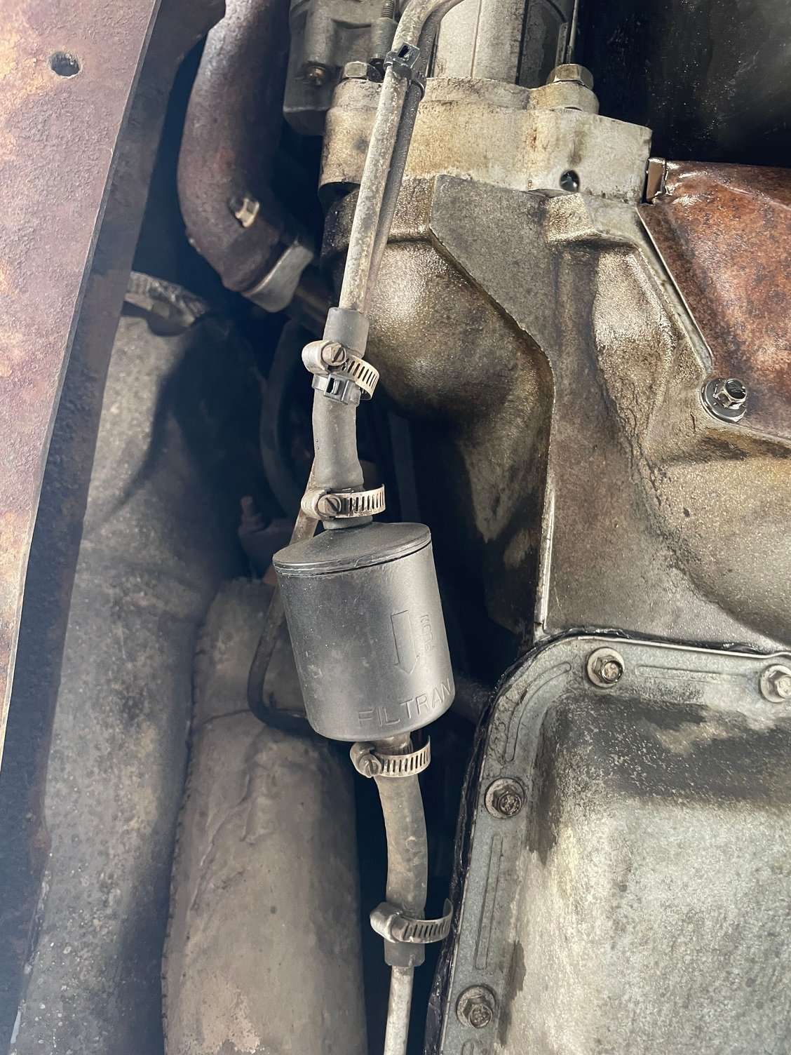

there is an inline filter installed on one of the hard lines for the transmission. I guess it could be disrupting the flow? And the sending unit for transmission temp is near that unit. Not sure if that’s an accurate reading. But also don’t know why it wouldn’t be
Is the sending unit in the cooler line? If so, that's the cause of your high temperatures.
The cooler lines run A LOT hotter than the transmission average temperature. A lot of people install the sender in the cooler line and then get scared of the readings. If you are only seeing 230°F in the cooler line your transmission is well within the safe zone.

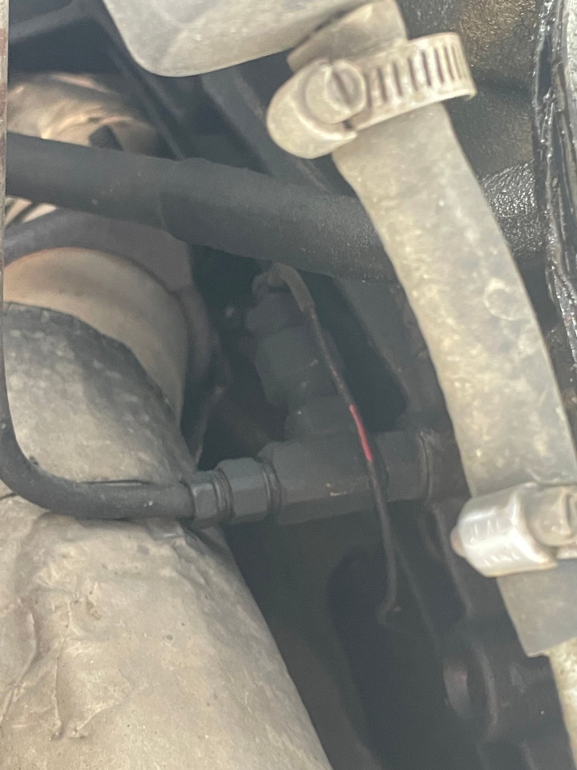

In line filter. Temp unit above that
Will the location of the sending unit throw off the readings?

You are probably getting high readings do to it being so close to the DP.

Yeah. I could see that. But the trans was seeping oil after it read near 230°F before getting the new cooler. Wonder if I can use that sending unit or not on the test port. But I’m thinking there must be a reason they mounted it there. Who knows how old these ISSpro gauges are though. Maybe they’ve changed the location since?

im just wondering if I can move that to unit over to the pan? I got a deep pan yesterday. Haven’t installed it yet though. It has a location for a temp probe in it or you can plug it.
