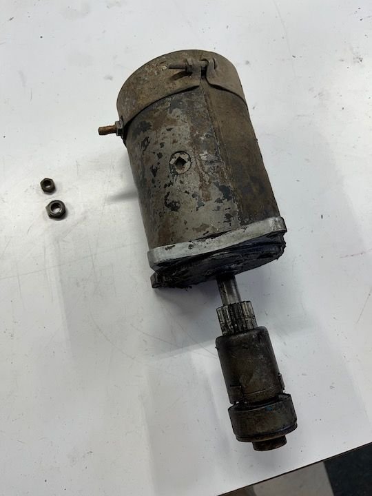

So, now I find the copper high current stud on my starter is mangled. PO had a clever spacer arrangement so that the nut used just the top few threads. Can be fixed by mortals? This may well be the original 6V starter running in the 12V converted truck. Don't know how to know that.
Do I do surgery? Or start shopping for a 12V replacement?
Thanks

The stud is replaceable: https://www.dennis-carpenter.com/tru...arter-post-kit
I find 6V starters to be of heavier duty (they need to be for the current involved - roughly twice as much as 12V) and they work just fine on 12V.

This a guy quite literally abuses a starter to get it apart and back together again. That gave me a good idea of what's inside. Curiously my "fly out" mechanism on the starter gear is also stuck "engaged" like his. It's not in the photo above. But while cleaning I spun it and it locked with the gear fully in towards the starter. Hum Bug.
Anyway, starting to think a rebuilt starter is the best path forward. Also this looks just like video starter, so maybe 12V already.

Generally, 12V starters will have 3 field coils, 6V will have two. An extended modern drive can be retracted simply by running the starter: https://www.google.com/search?q=yout...retract+bendix

Personally, if you have a shop that does remans on starters and alternators, I'd just drop it off there and have them go through it. Buying one from a parts store, even NAPA, would be a crap shoot compared to someone local and competent that knows what they're doing, and puts loving care into their work. My 2c.

I just replaced the stud in my 6 volt starter, I've done it before, it's not that hard. But, I also agree with taking it to a pro to have it checked and rebuilt. I have a local shop that would rebuild the starter for around $50, well worth it. I did mine because the starter looked to be in good condition. I ordered two studs, one just to have an extra, and had them delivered to a close by NAPA. I'm also cheap.

The chain stores managed to close down the 1 repair shop close to me. I don't recommend ever turning in your old part. Just pay the core and keep your original while looking for a rebuilder. Sometimes the 6 volt starters on 12V can hit too hard and mess up the ring gear or bendix. They sure spin them over good though. Some shops can convert to 12V.

I dropped it off this AM at the repair/rebuild shop in town, Starters & Alternators of NM. They are going to put in a stud and do a rebuild keeping the same drive gear assembly, which looks pretty good.
