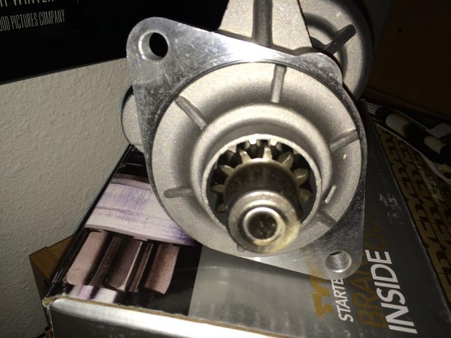

It came with a test sheet showing that this specific starter had been tested and passed various tests prior to being shipped (it's serialized so I'm not going to post it) as well as another page showing generic starter installation tips such as 'make sure your battery is fully charged.' Fairly well written, not Engrish. Once you remove those, there's some wrapping/packing paper and then the starter itself.
Pulled it out and got all-around pictures.
Looks to be well done, not your typically poorly machined Chinese-made Denso knockoff. I'll let y'all know how it does with starting after I install it sometime in the next few days.

Got it in. Fastest start up I've ever heard from an even vaguely cold early PSD. Started up with just a touch of the key after the WTS light went out. Didn't whack the batteries down anywhere near the same level the old starter did. More later, cleaning tools.

Sadly, it *is* made in China. However, it seems to be an original design, not a knockoff like most nameless China garbage. Also unlike most China garbage, it seems well machined. I get the feeling this is something that TYC is very interested in making a good impression with so they can break into the market, so they're not likely to suck.
