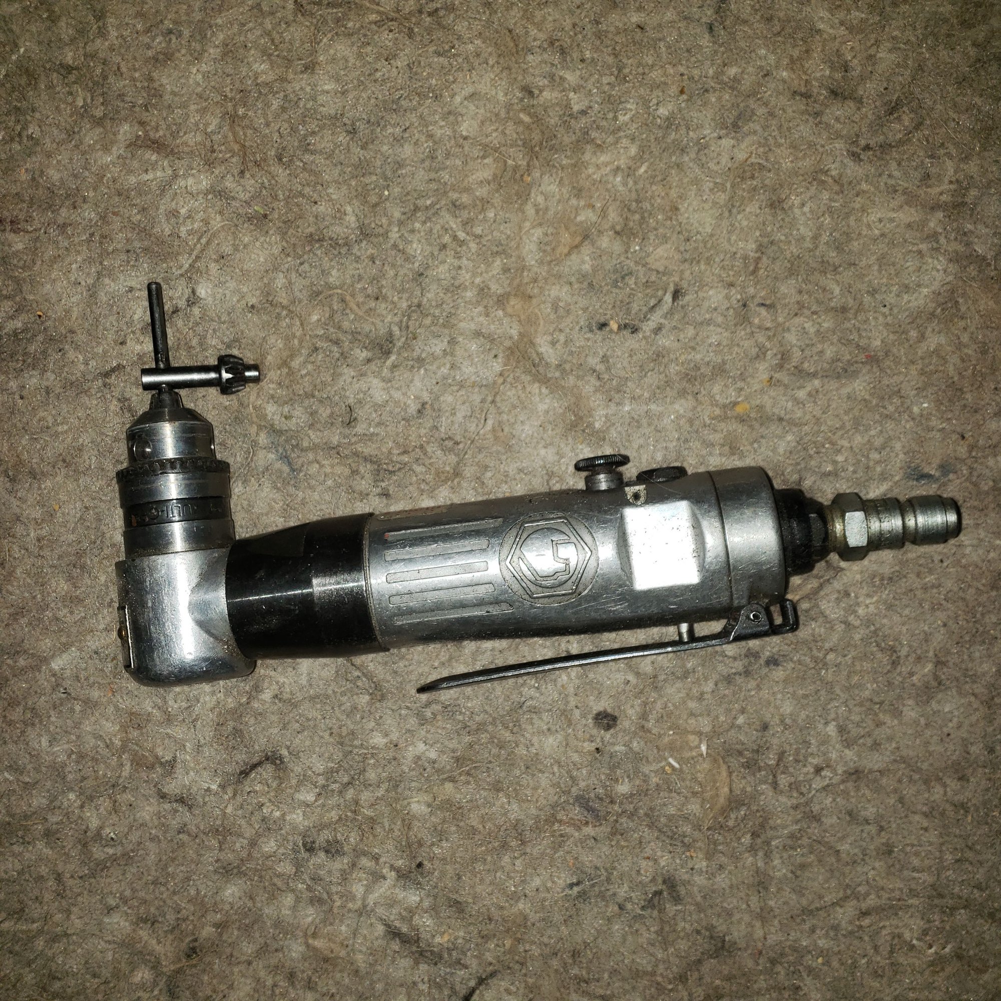

I personally would pull the air pump and fix the broken bolt
It will run till the cows come home, with the two that are still there
Chances are you can unscrew what's left of the bolt with your fingers 0r very little drilling with a left hand drill bit
I use an air powered angle drill I purchaced for freakin Bimmer waterpump bolts
Cheap (is relative) and easy with one of these

This Matco reversable angle drill was expensive, but is 30 years old and still works like new
