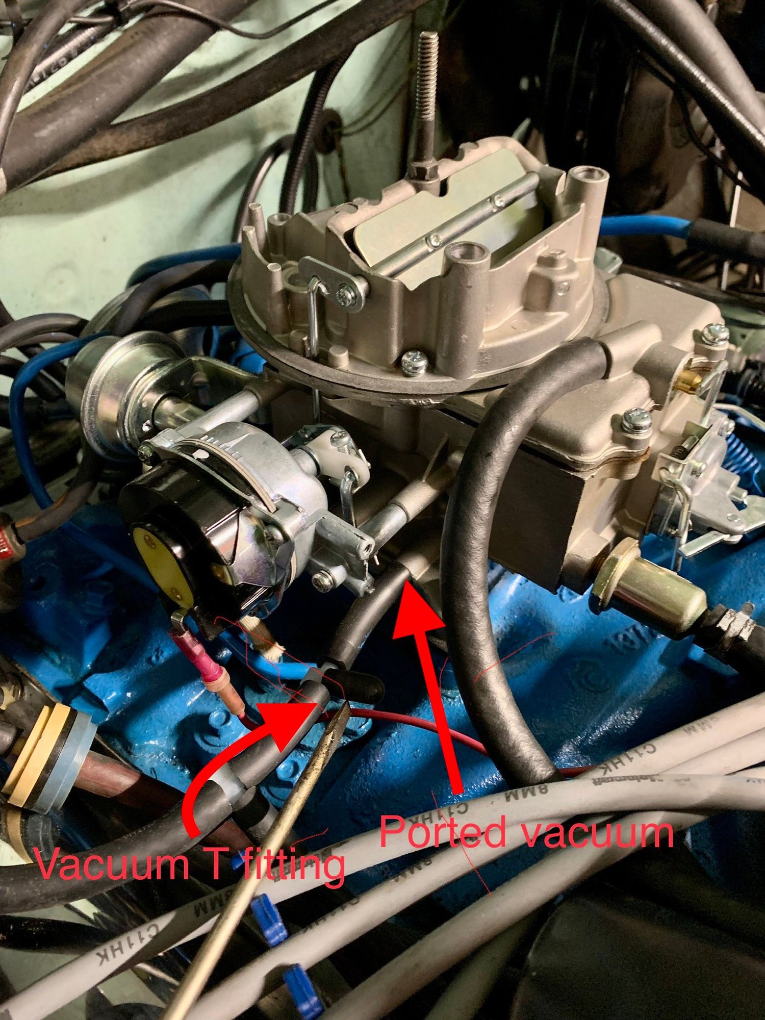

Here’s a quick picture of my set up.
This picture shows the ported vacuum line on the side of the carburetor. Which supports all my emissions gear. I tied into this line with a vac fitting, which is currently plugged in this picture. When I set vacuum advance up for ported vacuum, I tie the vac advance to this fitting and plug the manifold vac.
I will measure ported vac at 2500 rpm tomorrow — my guess is that I am nowhere close to manifold vacuum resulting in less timing advance.
I’ll also study the vacuum diagram below. Pretty sure it has the vacuum advance pulling from manifold vacuum.

Quick update. I spent an little bit of time, studying the vacuum routing diagram and my current set up. While doing so I found a cracked vacuum hose connector on the ported vacuum switch atop the thermostat. The related line ties into the carb S port.
I reconfigured the vacuum advance to run off of the S port on a carb (ported). Reset face timing to about 8 or 9°. Total timing is now around 55° as it should be.
The cracked vacuum connector may have been the problem from the beginning. I will get it out on the road and test it little bit later today.
