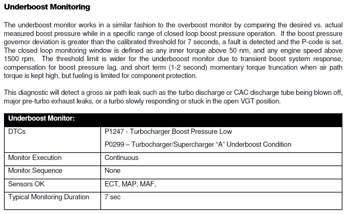

Old Apr 11, 2023 | 06:35 AM
kper05's Avatar
kper05
Joined: Jan 2010
Posts: 6,600
Likes: 84
