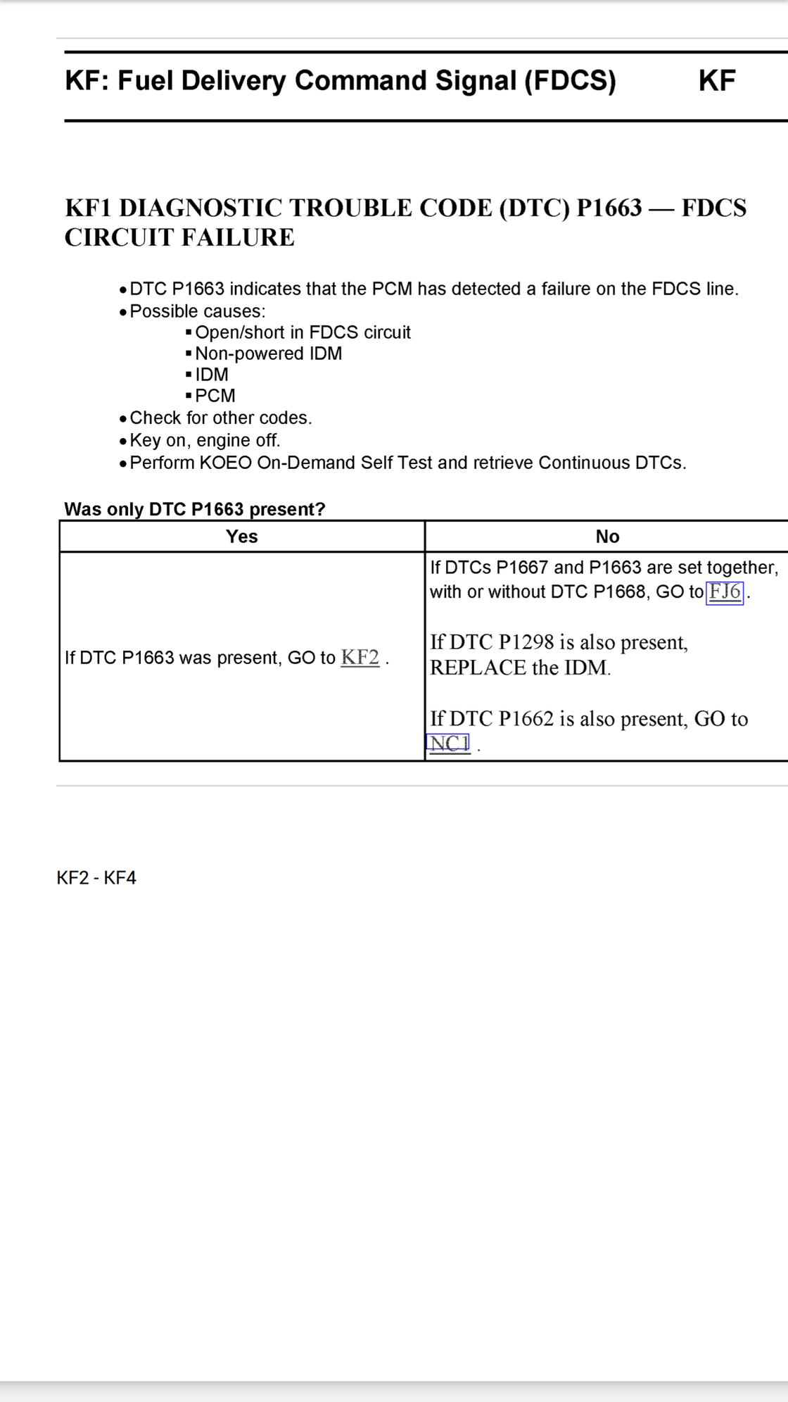

If nobody else answers give me awhile.
but, possible short to ground. Bad pcm, or bad idm.

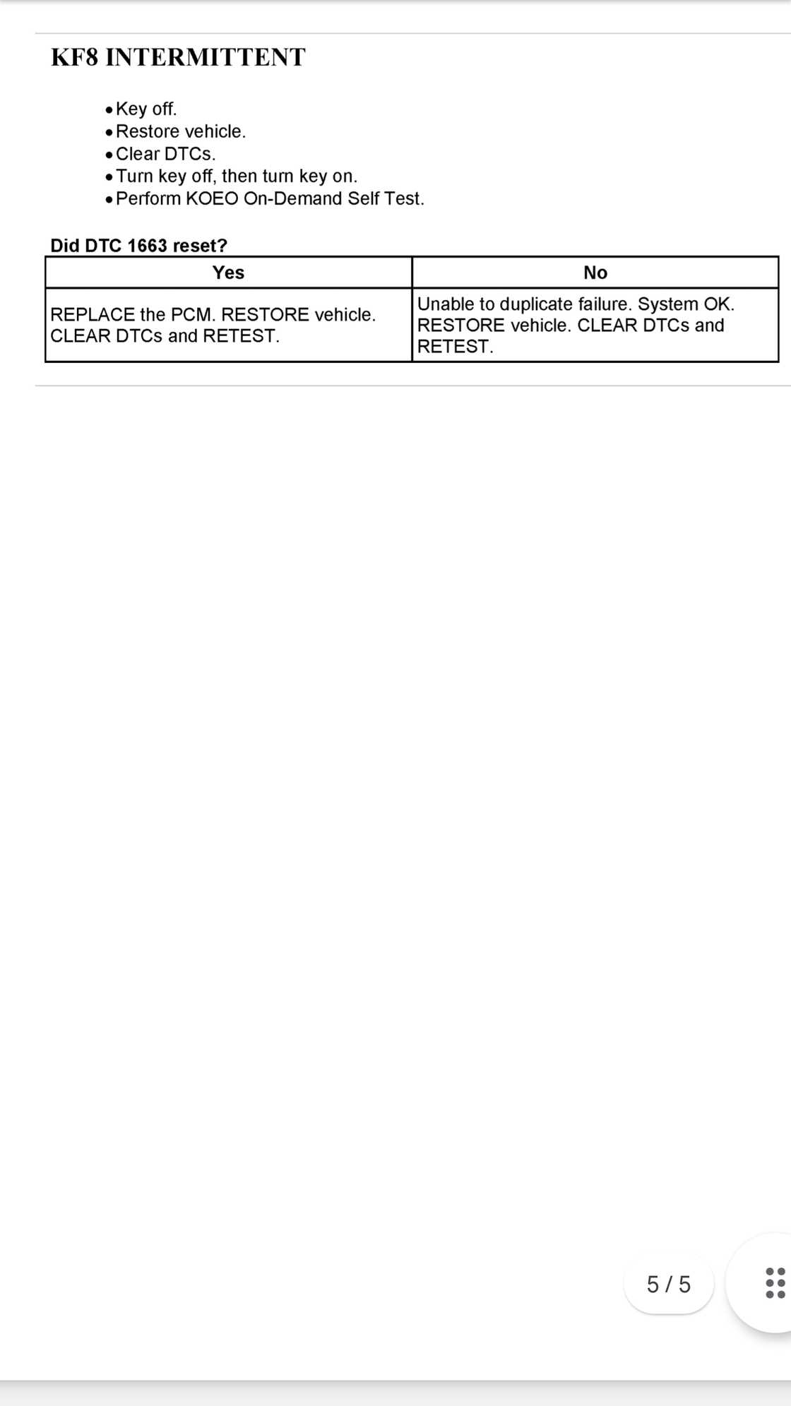

Old Apr 8, 2023 | 07:51 PM
