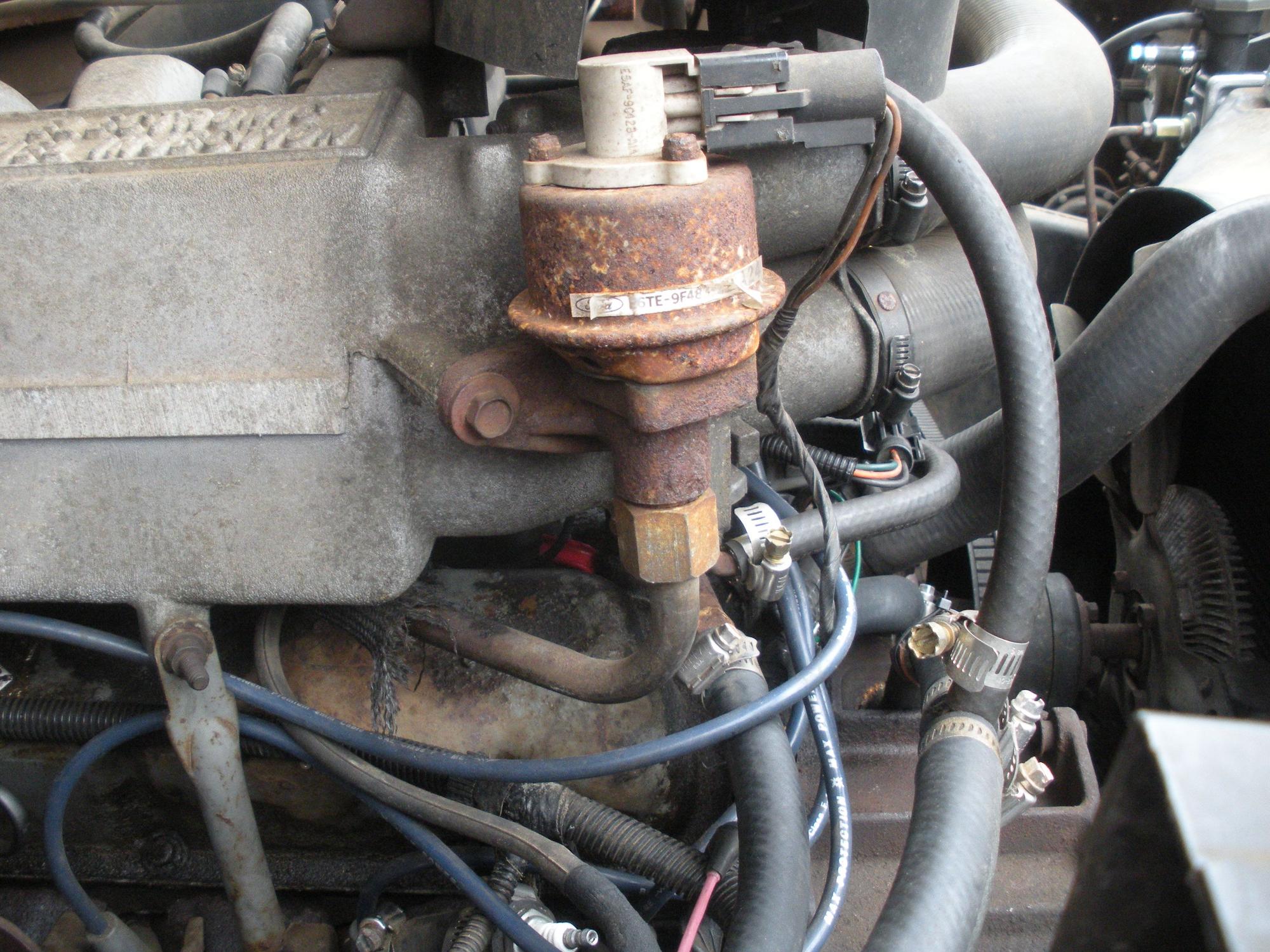

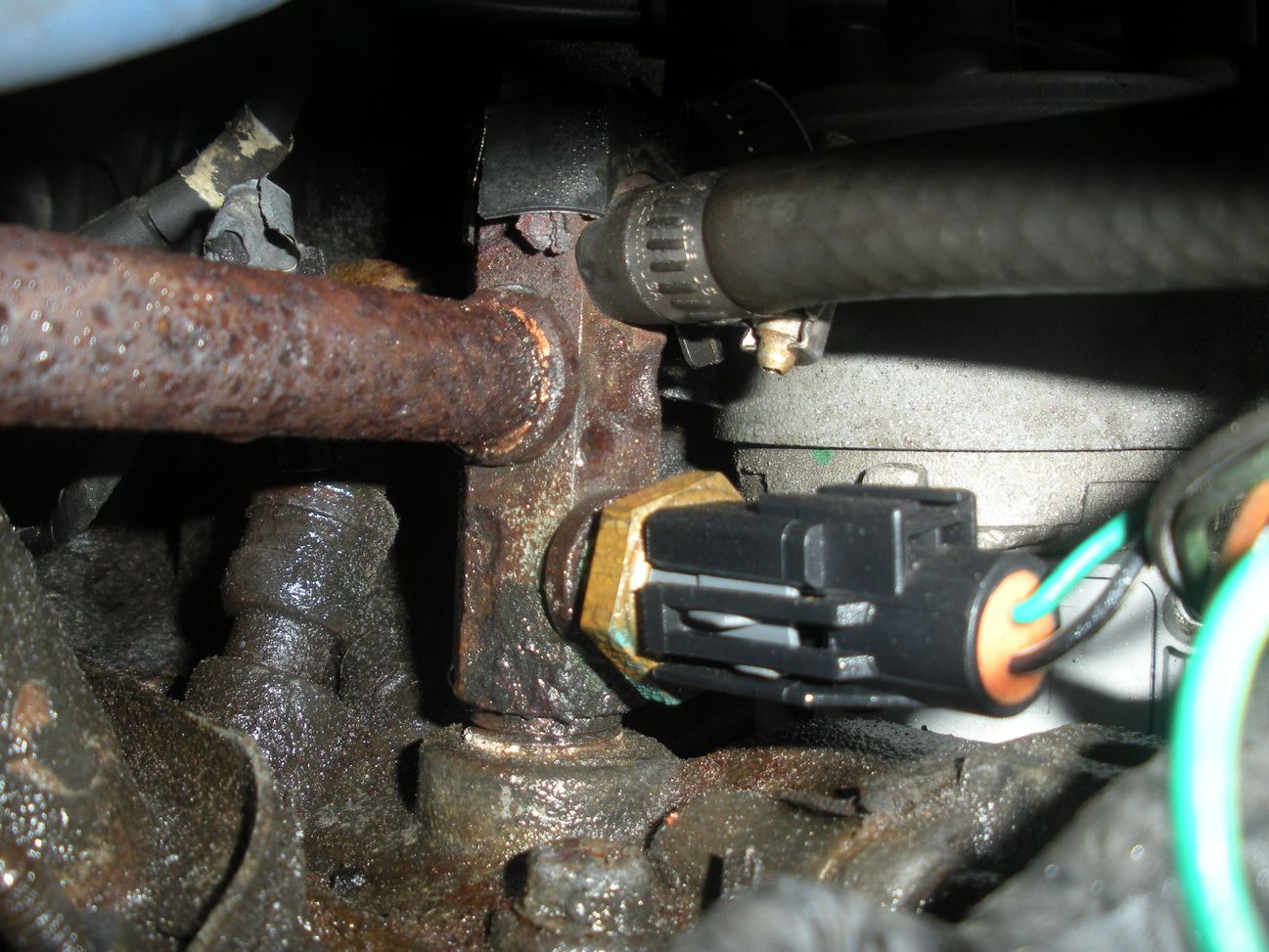

For those that don't know the 302EFI, I went out and took some photo's. DOn't mind the dampness, it's been cold, except for this morning it rained, and now it's 60F with more rain coming. The area is hard to get a good shot of.
I seem to recall a while back, someone made up the tree using pipe fittings...
I like the idea of just cutting off the rust and tap for NPT.

Looks like yours is not long for this world either.
No kidding! That's bad design using ferrous metal for that tree. The combination of heat and moisture is perfect for corrosion. I'm thinking a new replacement tree made from brass or stainless steel would make sense. At the very least brush on some Fluid-Film and keep it protected with a touch up periodically.

Yes, this ^ is in the plan for the near future. I do have fluid film on the shelf.
