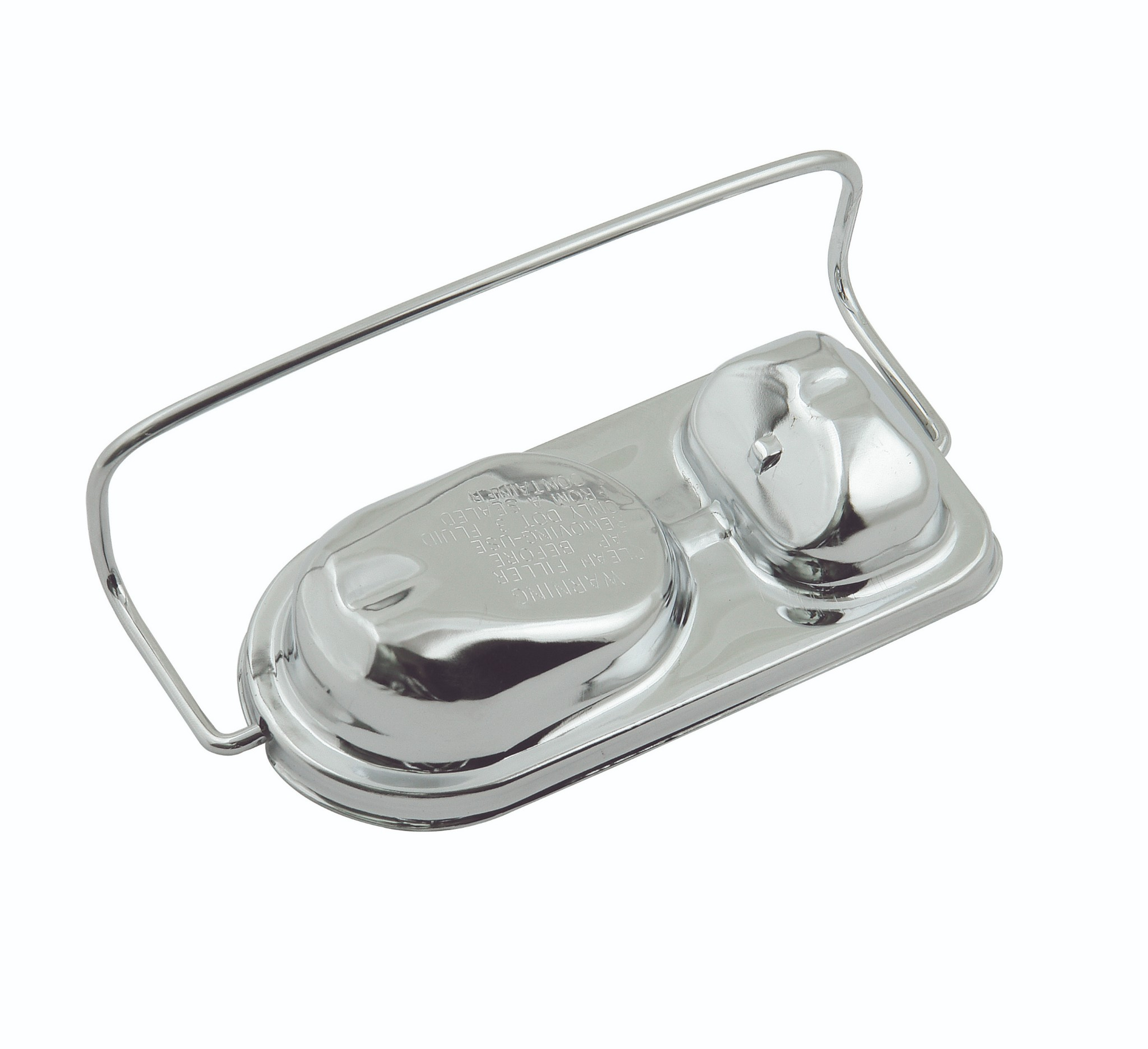

Anyone have a master cylinder cap for a 1983 master cylinder? Have repaired the front brake lines and need to make an adapter for a power bleeder. Please respond here or message me.

Here's one. They give the measurements so you can see if it fits.

Look for Mr. Gasket #5274:
https://www.holley.com/products/brak...ter/parts/5274

Got a master cylinder cap this morning for a reasonable price from a local guy with a few parts trucks. Still trying to come up with a 'no mess' plan to remove some of the fluid from the mc after bleeding.
