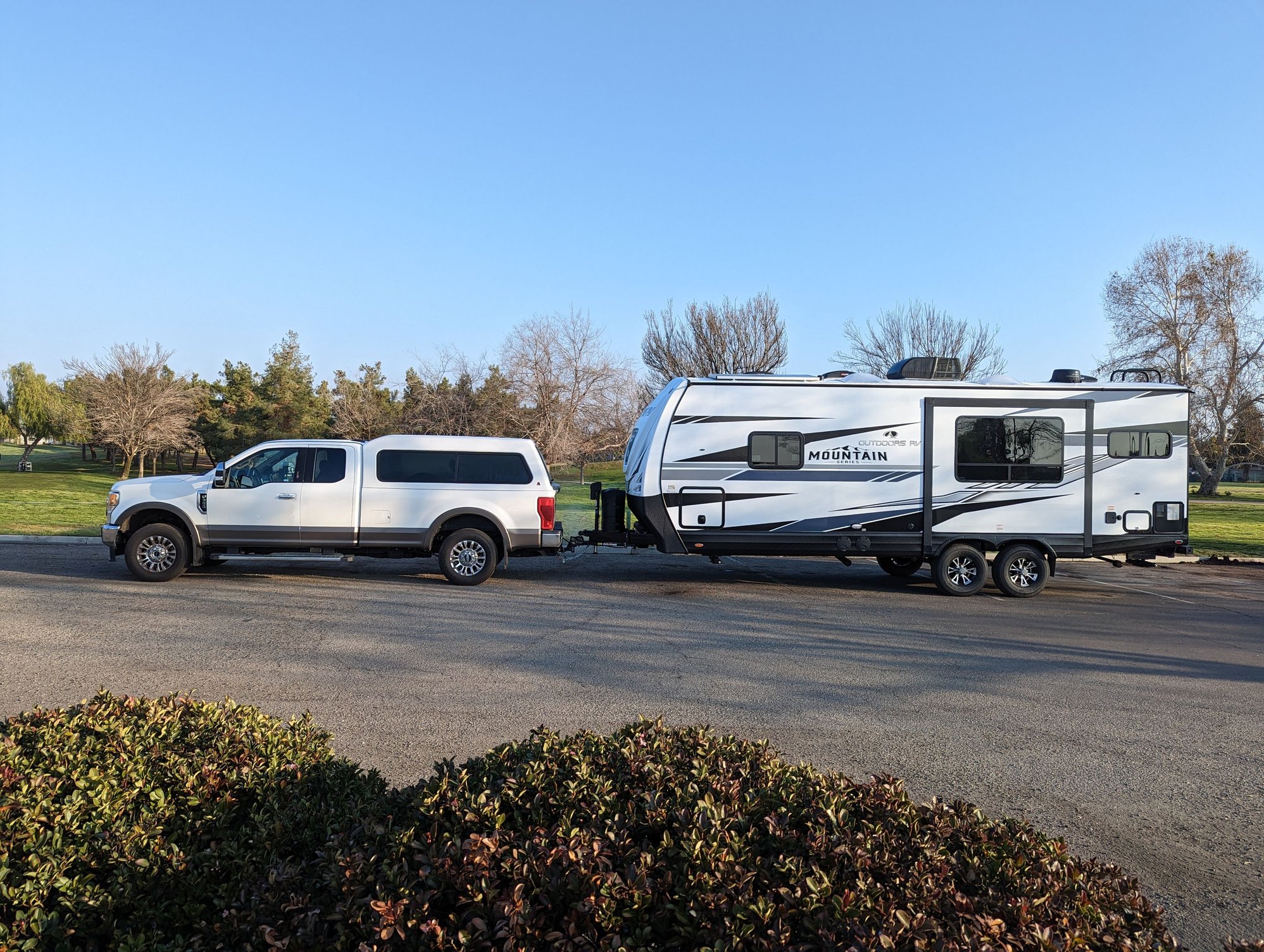

I have an Outdoors RV 24RKS.,... GVWR of 9,995 lbs. Ready to travel the trailer weighs 9,100 lbs with a tongue weight of 1,300 lbs. CAT Scale weights. I transferred our old Equalizer 4PT , which is 1000/10000, to the new trailer. Dealer said it would work fine... Used that size for all these trailers.
It didn't tow well (TV is 2022 F350) so I sent Equalizer an email asking for advice. They said that I should go with the 1,400/14,000 WDH setup. This being based on the 1,300 tongue weight (Outdoors RV's are usually very tongue heavy).

I'm not certain, just tossing this out there.....
The axle placement on the trailer will determine how you address the displacing of tongue weight.
Looking at your trailer, and its axles, they are placed well back of the center fulcrum of the trailer, much like my current trailer.
My last trailer had spread axles directly centered under it, and like a teeter-totter displacing weight quickly front or back it was easy to level the trailer.
Depending on floor plan you might not be able to put much additional weight behind your axles to help raise the front of it?
And I am thinking with the axles being further back, it takes more of a "upward" load or a stronger WDH to raise it, which then might make your front axle on the TV carry too much?
