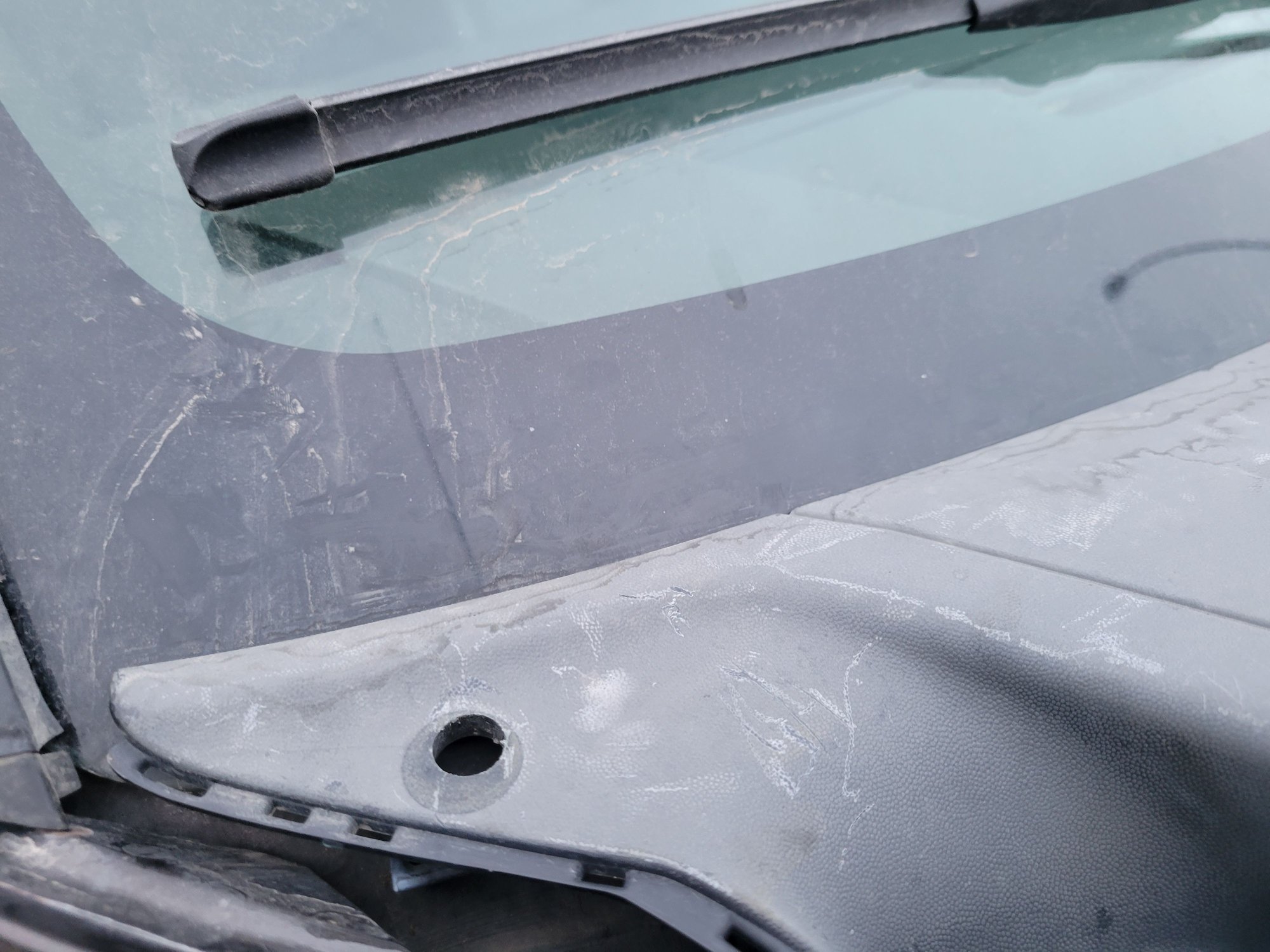

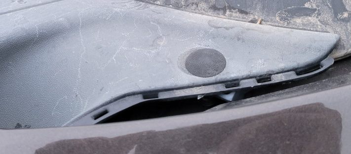

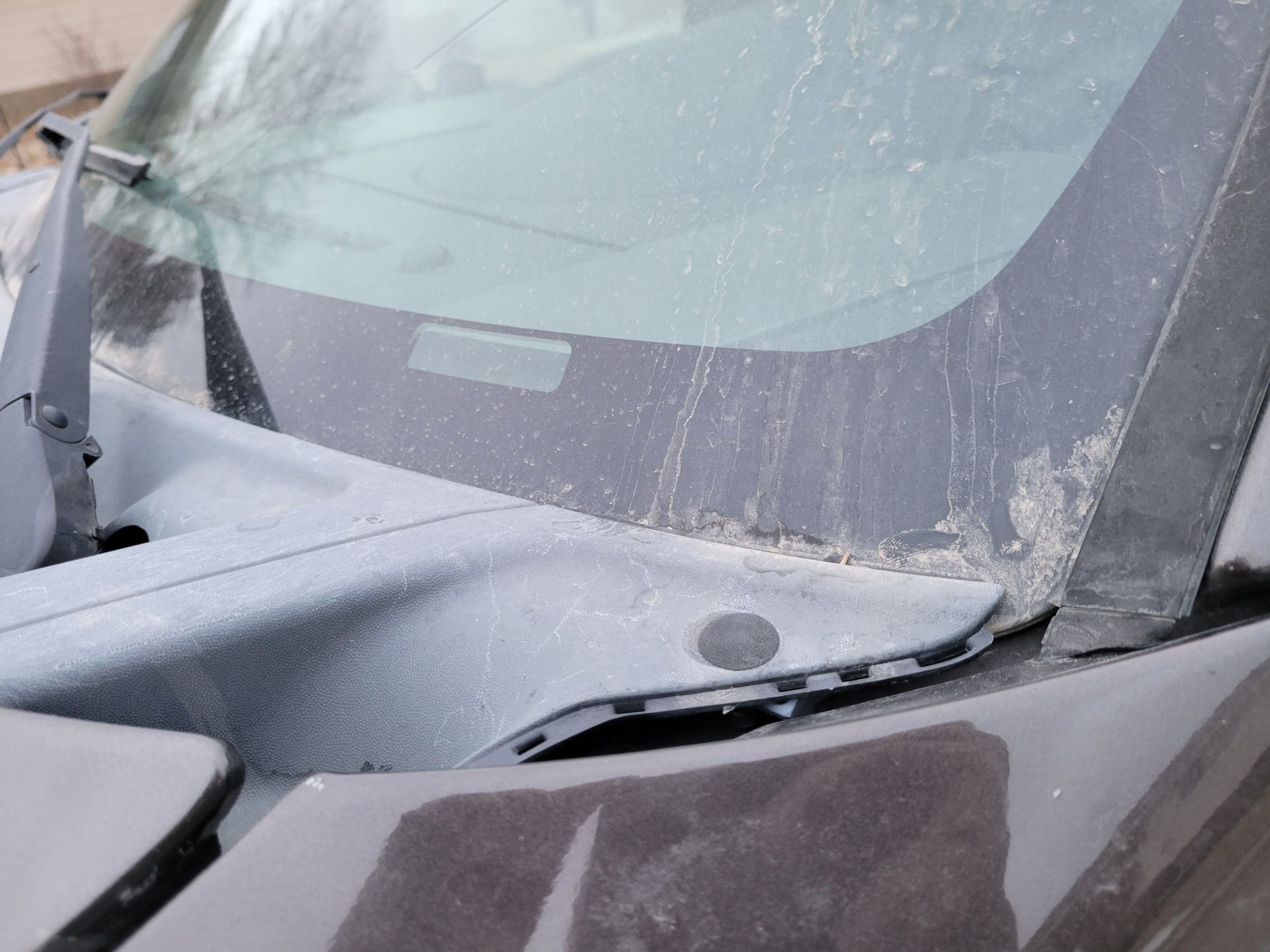

Was about to take it a part and saw it maybe wasn't put back together all the way. Any comments if it is missing any thing else than that plastic push screw on the the passenger side?

Go to an auto parts store and get a plastic T and some washer fluid line. Taking the cowl off is a very simple process.

You have to remove the wiper arms - its easy, there is a release on the side of the adapter, and they are indexed so they go back properly. You're also missing the end gap covers. I've replaced my cowl assemblies because of storm damage from a big limb, and the washer lines came on it. Those end 'push pins' are standard and easily found. I have no doubt you could fix it without replacing the cowl assembly but without looking at in I couldn't say exactly how you would do it - it'll just be obvious when you take it off. If a 'T' is broken it probably got that way from using just water in the washer and it froze. If that happened, you're lucky the pump didn't freeze and leak. If you have to take the cowls off, its a great time to clean out the under-cowl area which is usually pretty dirty.
