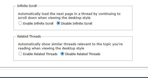

Old Feb 25, 2026 | 04:17 AM
01__Excursion's Avatar
01__Excursion
Joined: Nov 2017
Posts: 3,096
Likes: 534
From: Rock Hill, SC
Drop down arrow to the right of your screen name, choose edit options, scroll down to Thread display options.
