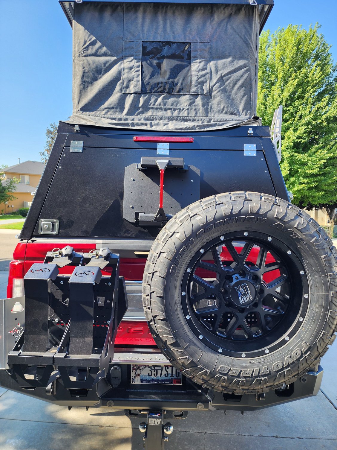

2017 F250 CCLB, bumper and tire carrier are expedition one products.

Man I wish you sent this a day earlier. Just ordered a titan spare tire carrier for my bed.
Can you send me the link for your setup please? Id rather have full use of my bed. Did you have to Fab it up or was it just bolt on? Thanks!
https://www.palletforks.com/accessor...waAs79EALw_wcB
No fab needed, you will need to drill a 5/8" hole in the frame to secure the new bumper brackets.
https://www.expeditiononestore.com/F...17_p_1105.html
