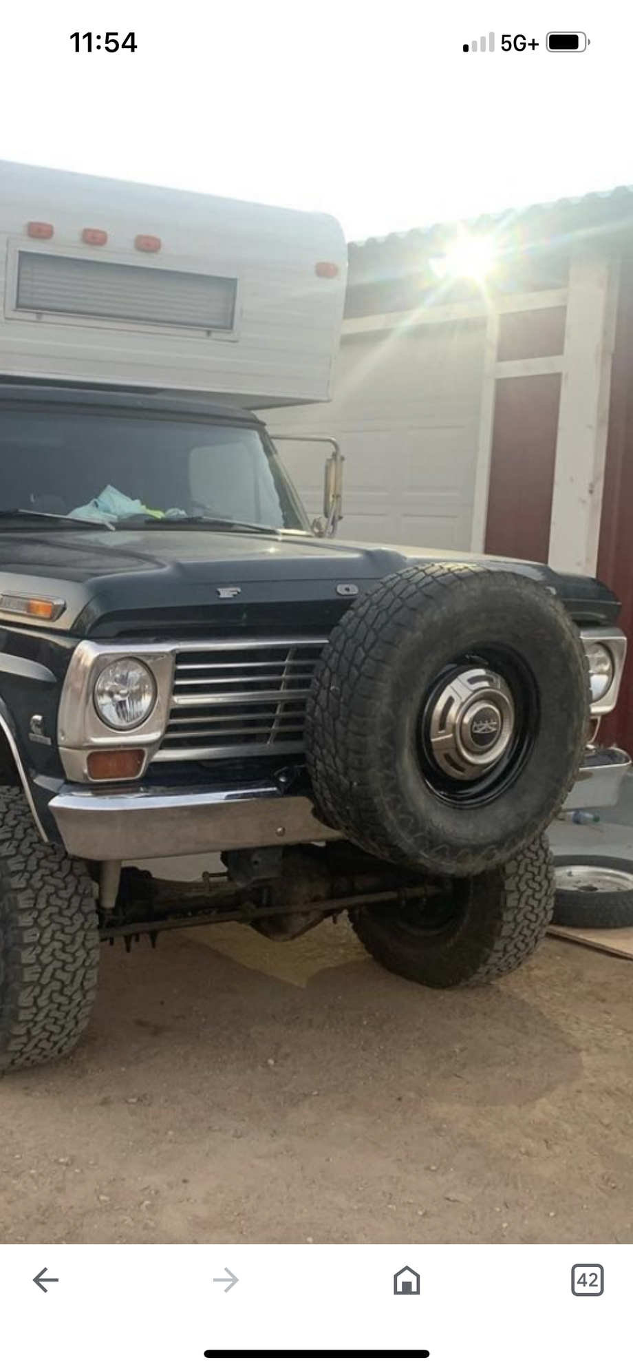

Front mount tire carrier something like this

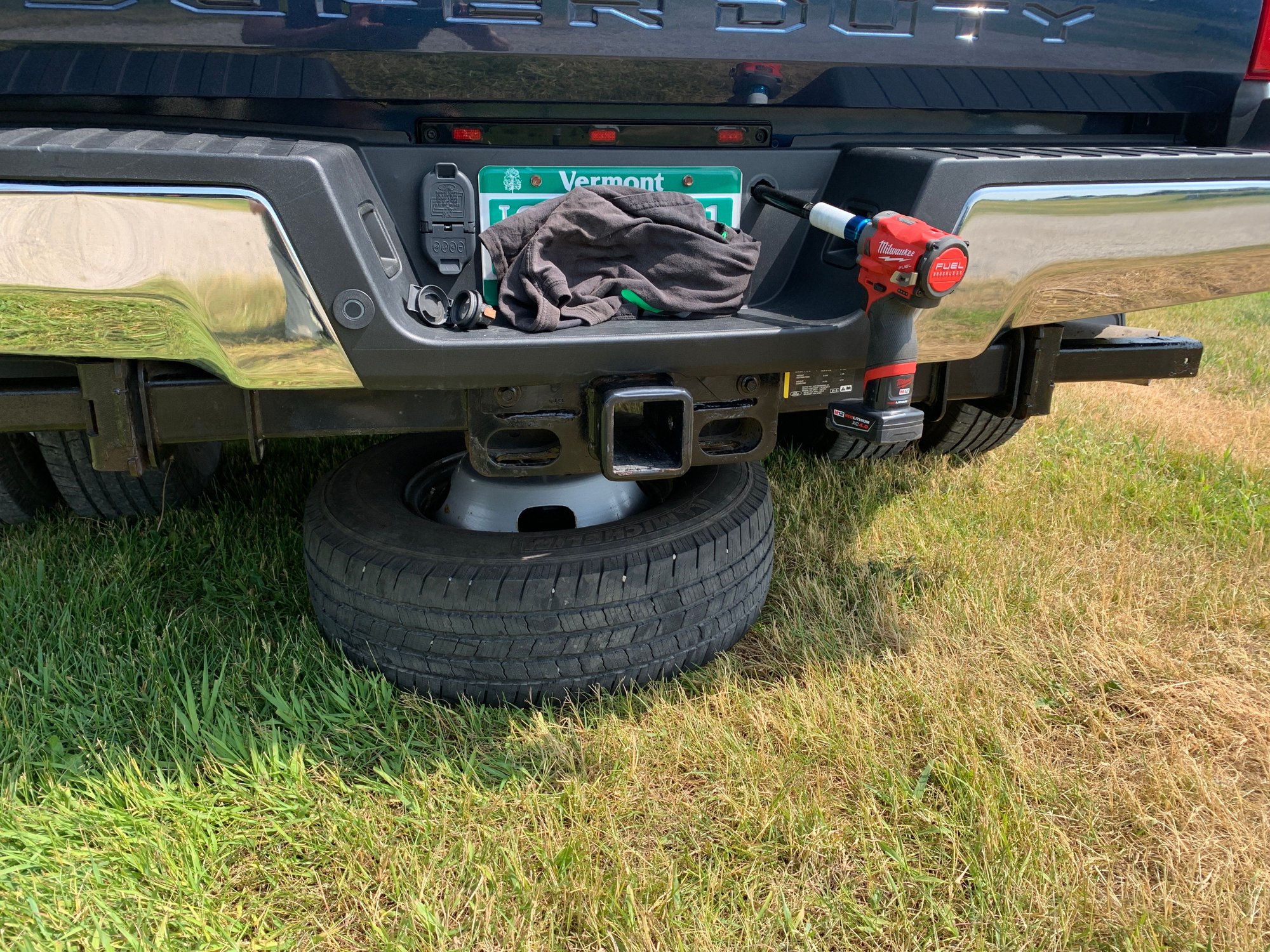

I left the spare tire where Ford put it. I’m able to remove it with the camper in place (AF990) by using the first length of the Ford tool with a portable impact driver I carry in the truck.

Camper not on in this photo but you can see how it doesn’t interfere. 17mm socket first length of Fords tool.
