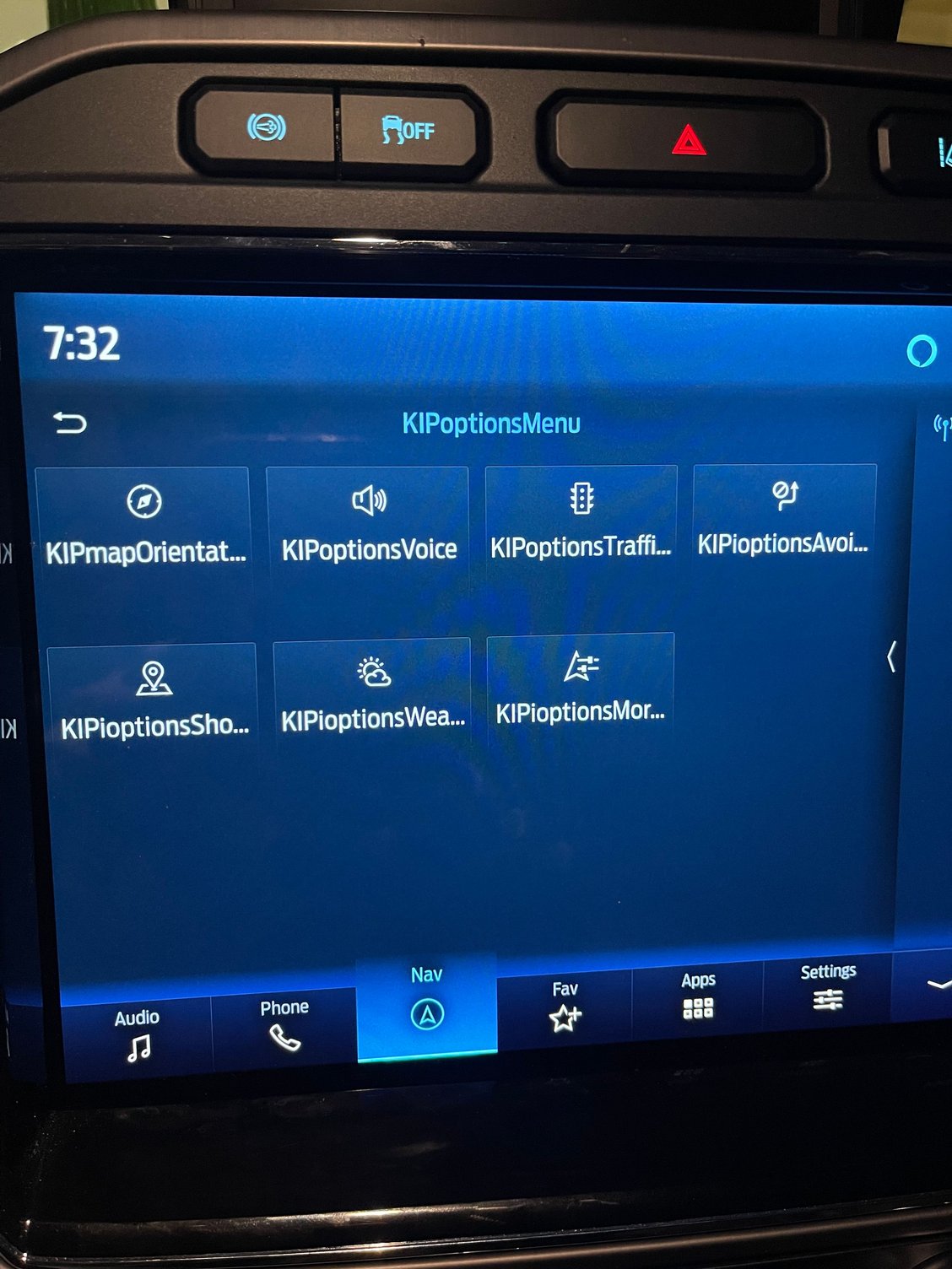

Just noticed after some update my Nav screen has gibberish jumbled word in search field. It says Kip connect. Anyone else have this?

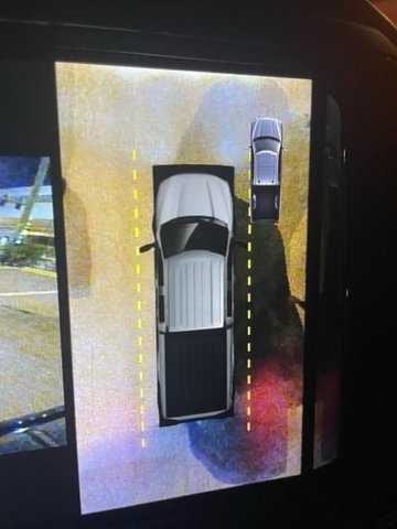

My truck has received two OTA updates in the last month. One added Alexa and yesterdays (3.5.4) mentioned the dual phone/screen resizing and updated owner's manual. Navigating seems fine.
Other than the Alexa symbol the only other change I've noticed is when I activate the 360 cameras I now see two trucks on the screen whereas before I only remember the standard big one.

Ees73's Avatar
Ees73
Joined: Aug 2018
Posts: 94
This is what I get with Nav now I've seen others have this on the tremor forum

Does you truck have a name? I SUGGEST KIP...
I went and forced an update earlier and got 3.5.3. I did it again hoping to get 3.5.4 for full screen CarPlay. Now I'm worried I'll get the KIP bug....
