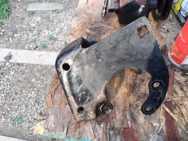

I finally got out to the one user-friendly "pick-n-pull" I have found in the state of ND. Of course it was the hottest day of the year! Anyway...harvested a Saginaw pump, brackets, and hardware. What you're looking at is numbered E3UA 3C511 HA. It looks like the bracket from post #1 but isn't listed on the chart in post #13. It is off a 1984 E150 van with a 302. (At least according to the VIN number.) The slot looks similar to my original in Post #14, so maybe what I currently have will work.

Just undid the pump from the "3A732" bracket. The number stamped on mine is E3UA3A732GB. This from Number Dummy (2006):"E3UZ-3A732-A .. Saginaw P/S Pump Adjusting Bracket // Marked: E3UA-3A732-GA or GB / Obsolete
1983/86 E100/350 V8 except 6.9L Diesel // 1987 E150/350 V8 except 6.9L Diesel and 7.5L (460) EFI"
Again, my pump and brackets are from a 1984 E150 Econoline, so the stamped numbers fit Number Dummy's parameters. Will post pic of 3A732 bracket soon!

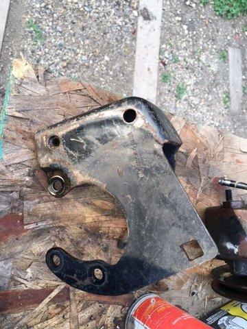

from 1984 E150 van E3UA-3A732-GA
another view

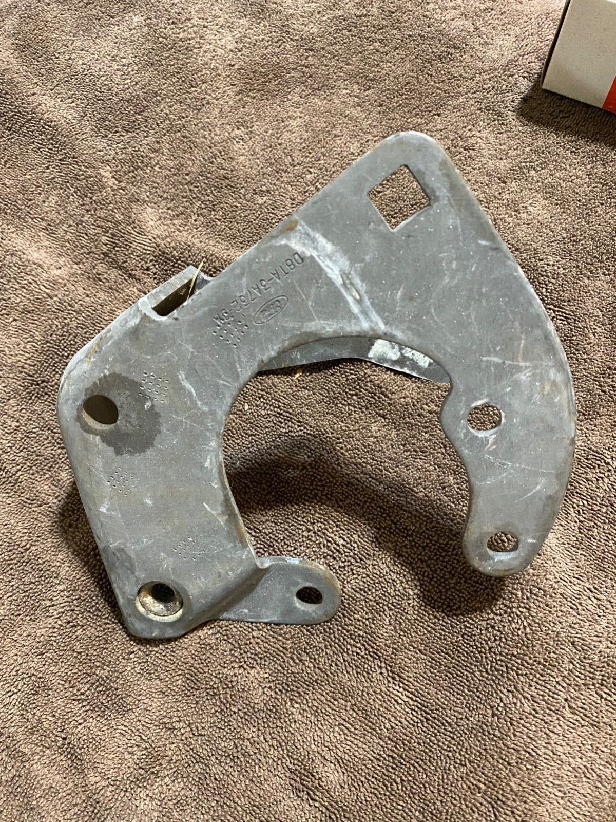

D8TA-3A732-BA (grey)
bottom photo
E3UA-3A732-GA (black)
These brackets are very similar. I don't know if they're interchangeable.

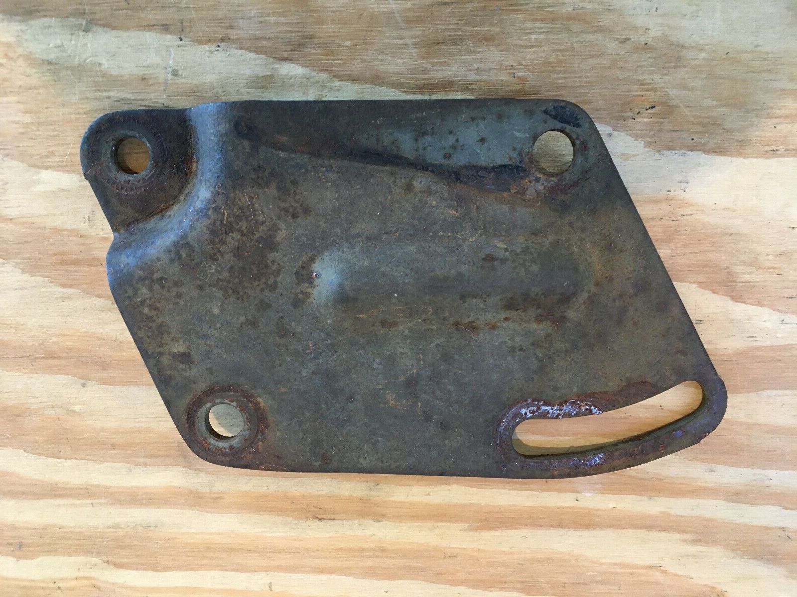

D7TA 3C511 MA (post #14) and E3UA 3C511 HA (post #17) are NOT interchangeable. Out of curiosity, I tried to mount the E3UA3c511HA from the van to the Thompson pump bracket in my pickup. They are VERY close, but some modifications (to adjustment slot) on D7TA 3C511 MA would have to be done to work with Saginaw bracket E3UA-3A732-GA. And to answer LANDANDSTONE, I am not upgrading from WIldhorses. I am upgrading to a Saginaw pump salvaged from a 1984 E150 van.
