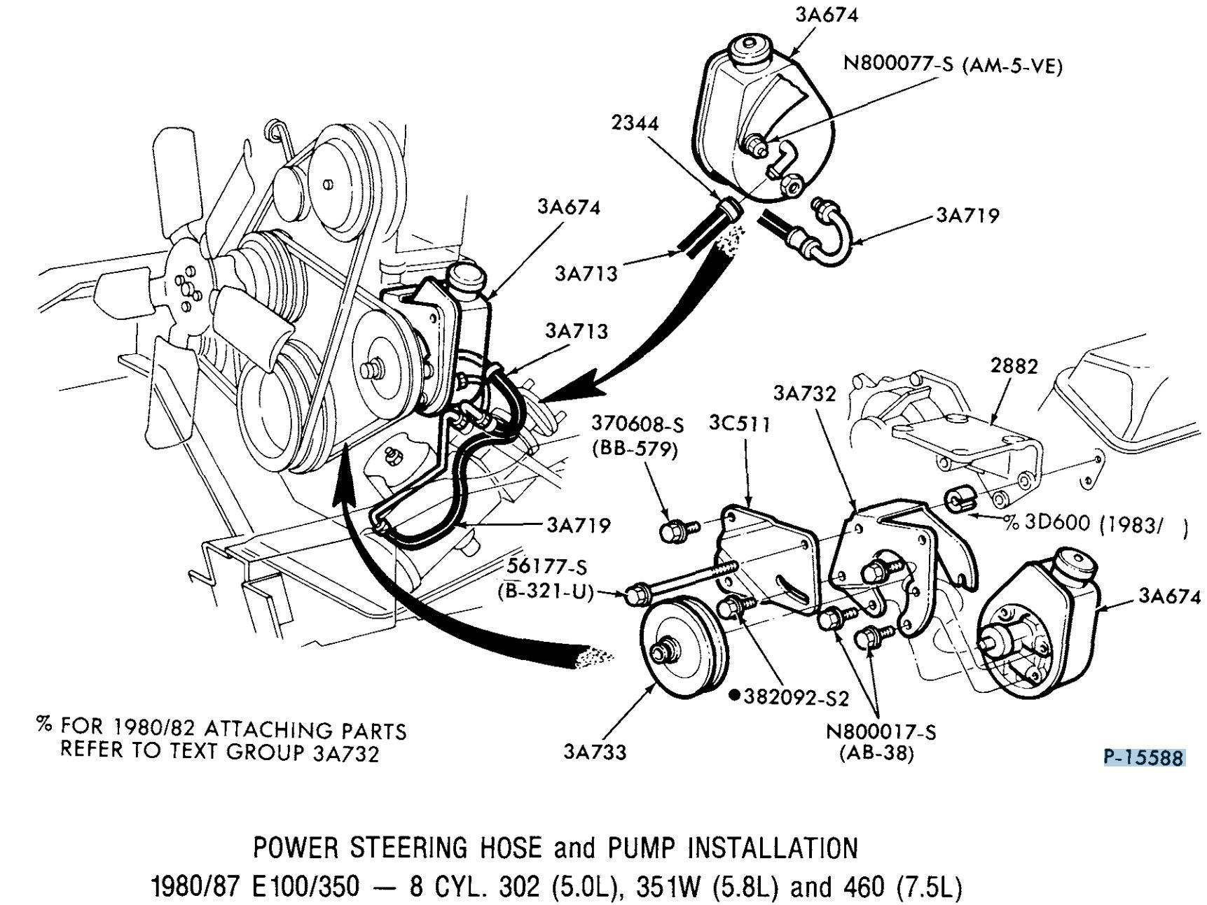

Is this what I should be looking for?

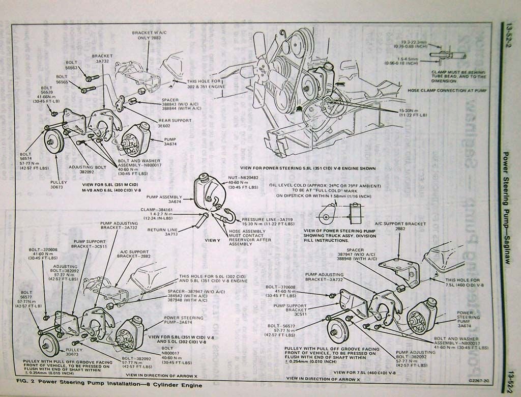

Anyone got a picture like this but for a 302?
Old Mar 4, 2023 | 02:01 PM
5851a's Avatar
5851a
Joined: Oct 2006
Posts: 4,029
Likes: 891
From: East Central Ia
No picture but it looks basically the same on a 78 351W E150. That style of bracket and threaded screw tightener seemed to vibrate at lot at idle speeds. I even asked at the dealer if it was missing a support brace, they said nope. Never did fail.

Bottom left looks like it's for a 302.

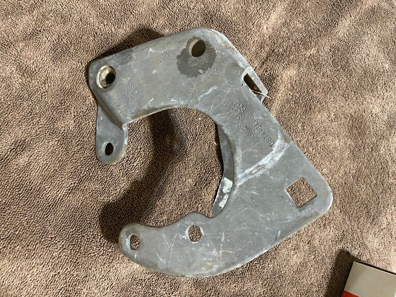

Old Mar 4, 2023 | 08:04 PM
msalander's Avatar
msalander
Joined: May 2020
Posts: 292
Likes: 21

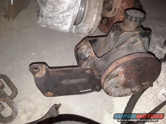

The main bracket number needs to be D8TA-3A732-BA for a 302. The smaller support bracket currently on my pickup is D7TA 3C511 MA. I don't know if this bracket is compatible with the main Saginaw bracket. I will keep researching for anyone following along.
Old Mar 4, 2023 | 08:09 PM
msalander's Avatar
msalander
Joined: May 2020
Posts: 292
Likes: 21
Here it is in actuality. D8TA-3A732-BA

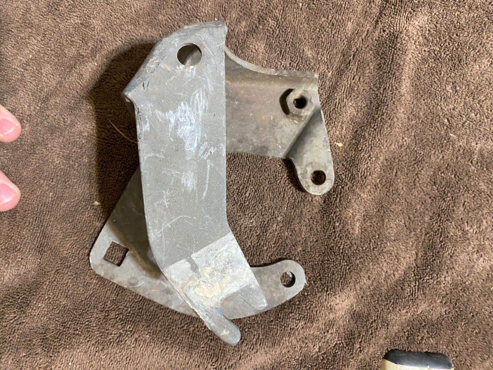

Old Mar 4, 2023 | 08:11 PM
msalander's Avatar
msalander
Joined: May 2020
Posts: 292
Likes: 21
Another view. D8TA-3A732-BA

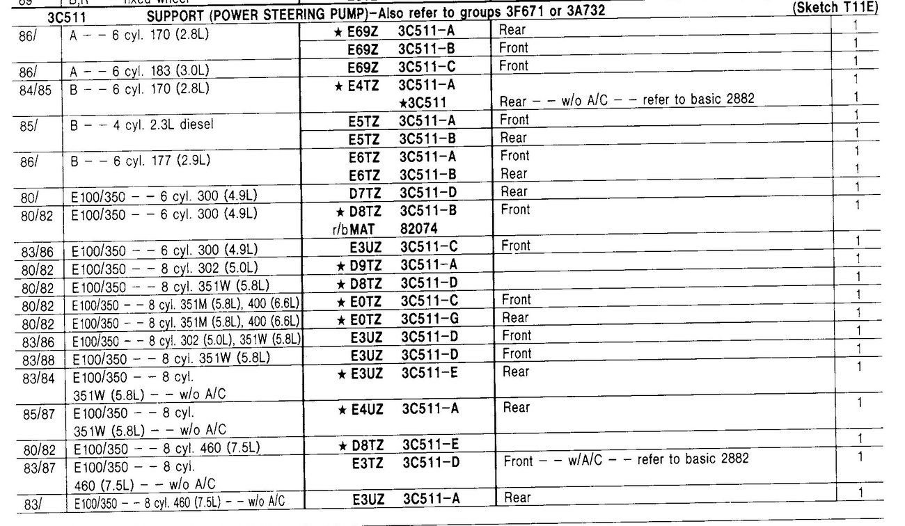

Clearer picture! The 3C511 bracket specifics are yet unknown (at least by me!)
Old Mar 5, 2023 | 03:29 PM
msalander's Avatar
msalander
Joined: May 2020
Posts: 292
Likes: 21
so...it comes down to 3: D9TZ 3C511 A, D8TZ 3C511 D, or E3UZ 3C511 D

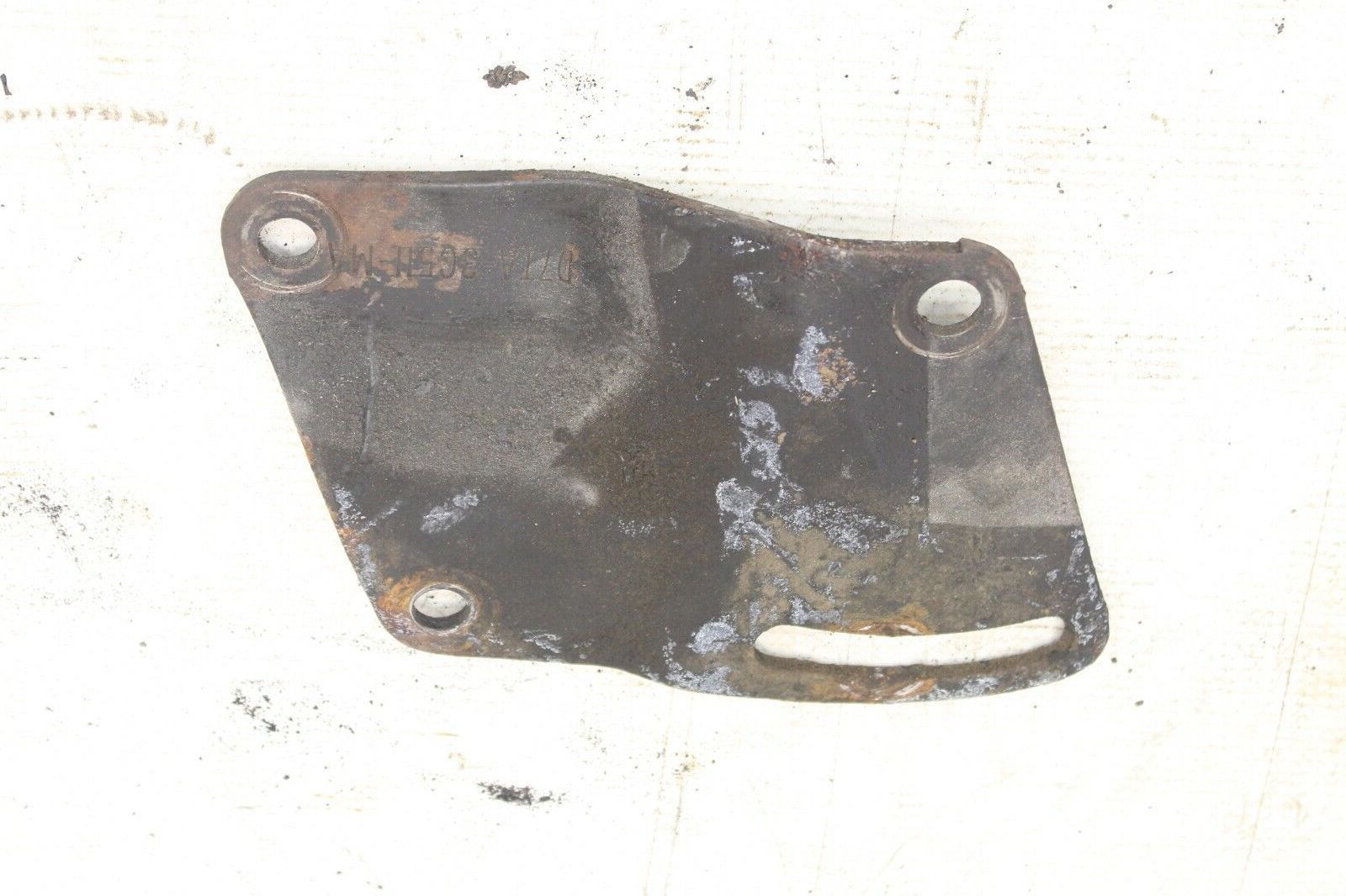

Again, this is what is currently on my 1977 F100: D7TA 3C511 MA. It came from the factory with a 302, non A/C. My current pump is the Thompson/pencil neck pump

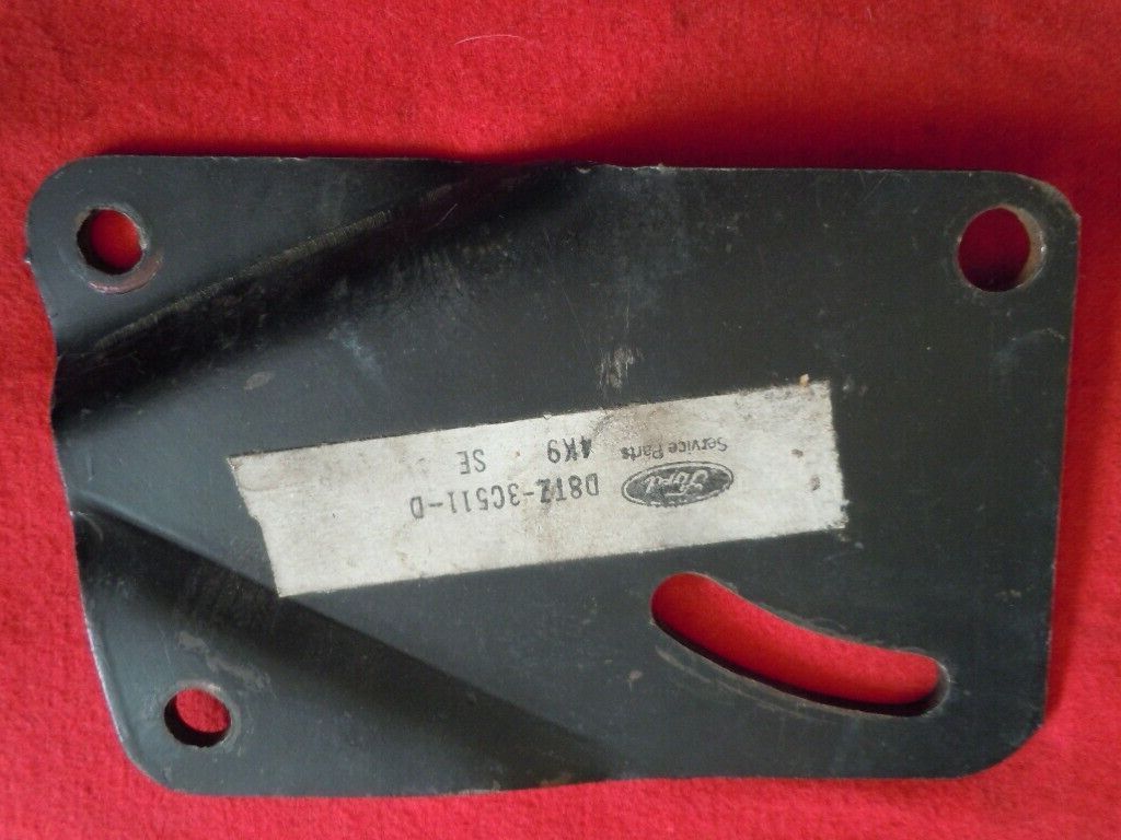

D8TZ 3C511 D. This is a contender for the Saginaw swap. This looks very similar to the drawing in post #12. I notice the adjustment slot is quite different from my current D7TA 3C511 MA makes me believe my stock 3C511 won't work.
