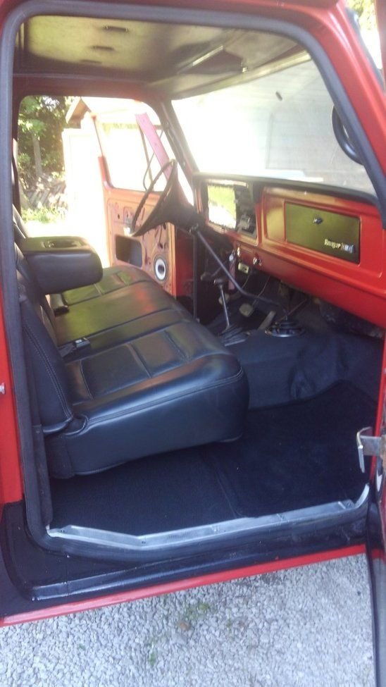

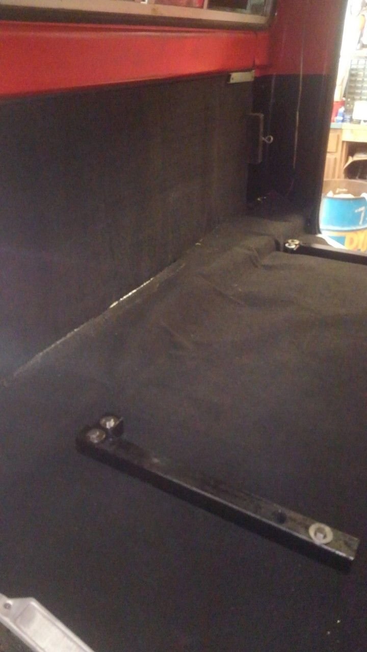

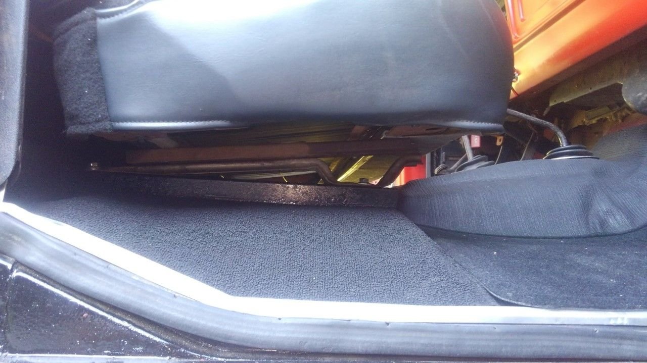

Easy to take it to a quality upholstery shop. They sell repop bottom cushion (if needed), but that back pad is hard, if not almost impossible to locate. Or shop for any seat out of a Ford truck up to a 1996 and bolt your 75 sliders onto the frame and put it in. Or shop for a 2000 ish Super Duty Crew Cab REAR seat. Take off the OEM fixed risers, bolt on your sliders and there you go. I did have to make some risers out of square tubing.

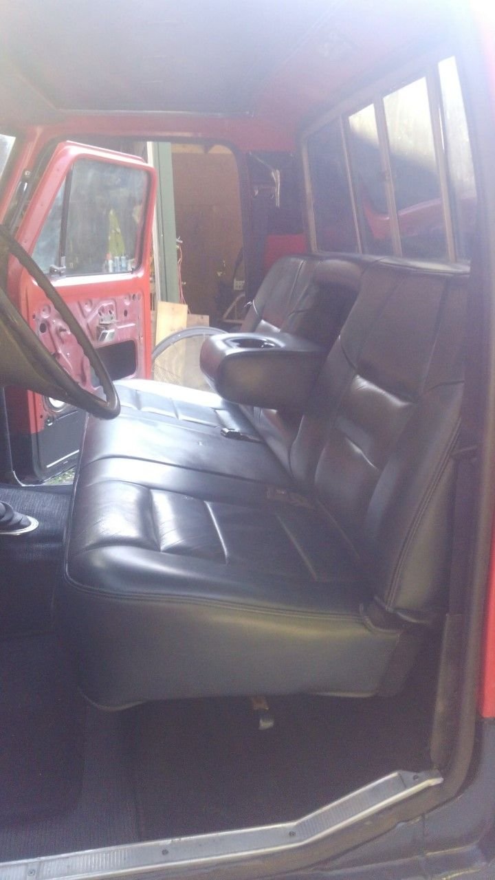

You can use any ford truck seat up into the mid 90s. You bolt your seat tracks on to the later model seat and it bolts right back into your truck. With the 90’s seat you can get arm rests, head rests and lumbar support I have a seat out of a ‘92 in my ‘71 highboy. Better chance of finding a seat in good condition. Good luck

bigboyhighboy's Avatar
bigboyhighboy
Joined: Feb 2023
Posts: 45
Don’t have the original rails. They were gone when I got the truck

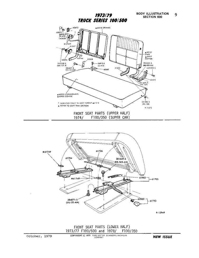

Old Feb 24, 2023 | 07:49 PM
77&79F250's Avatar
77&79F250
Moderator & parts slinger
Posts: 50,260
Likes: 5,819

Do the backs pivot or should they be fixed solid?

Old Feb 25, 2023 | 06:45 AM
77&79F250's Avatar
77&79F250
Posts: 50,260
Likes: 5,819
Well you do have the gas tank in the cab, so no real need to be able to fold the back up. Unless to get to the sending unit, but it should slid far enough fwd for that. I do not know of a bench that does not have the pivot ability. Also when searching, even if you get a split folder out of a 73-79 Super Cab or a 78/79 Bronco. Pretty sure it will work in your truck.
