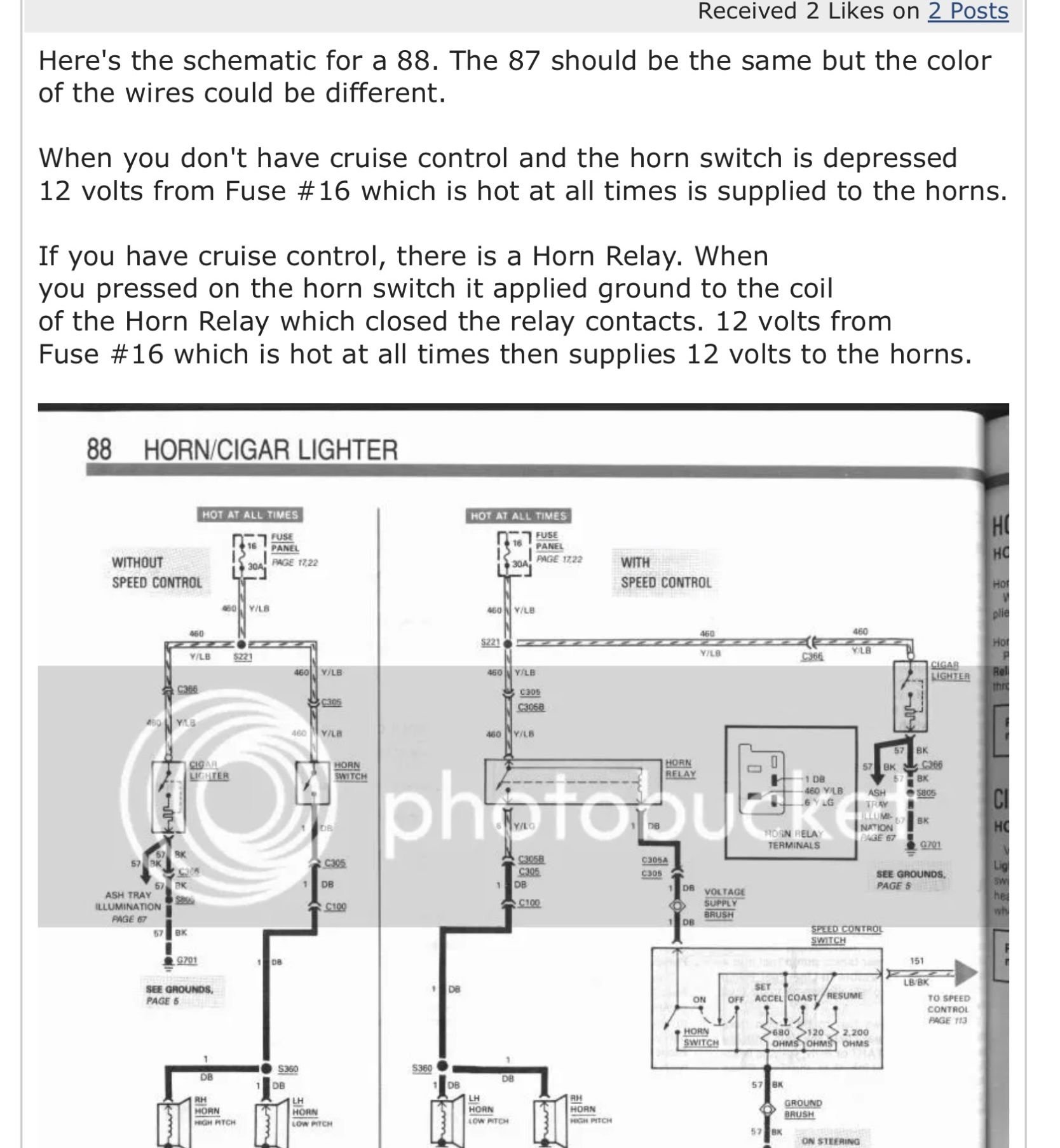

Is this correct? If so I need to get a tilt column again soon.
you need to dump PhotoBucket,
they put that overlay over images and ruins them.
use Imgur instead, they don't do that.
https://imgur.com/

I didn’t even know this company existed. It was on a forum. Someone posted the photo with a comment, I just screenshot the photo of the thread and edited it.
Is the text above the photo bucket photo correct with the guy saying something about fuse 16?

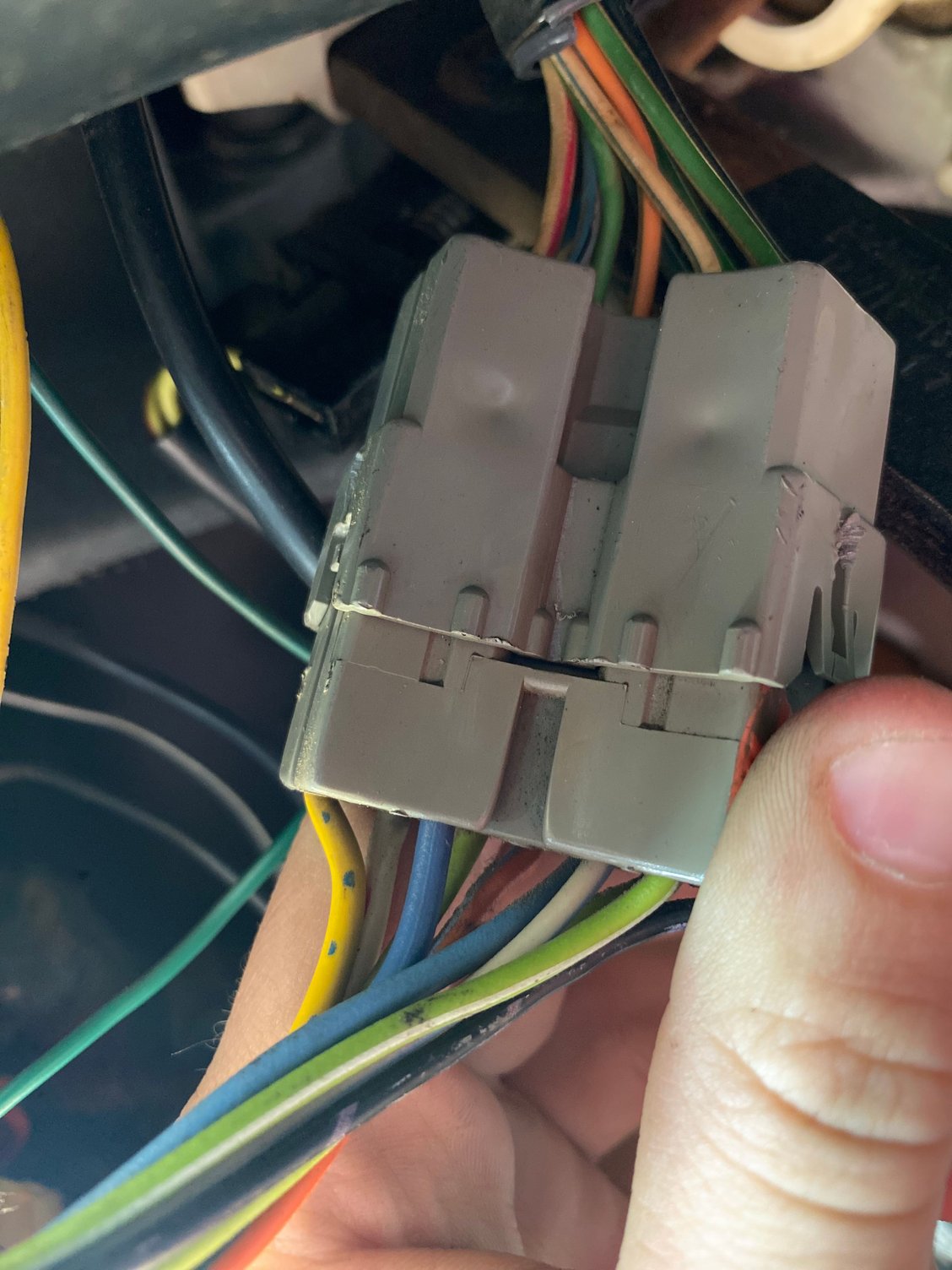

So I just went to the junkyard to get a tilt column and they didn’t have any. I messed with it more even with the ignition off and the key turned forward one it still makes the horn stop working. Why?

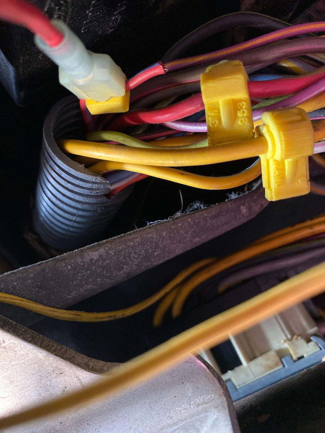

You can see on the back of the connector that there’s mis match wires. But then the broken spliced whatever it’s called wire isn’t those colors
It comes from this
And goes to this
