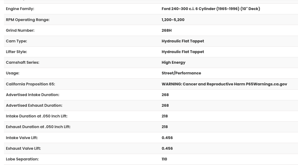

also ive been looking and ik there are alot of people that are not fans of them but what do you think about the comp cams 268 cam?

The Comp 268 cam has low valve lift and will work with your cylinder head since it has short valves and limited valve lift.
The Comp 268 cam kit comes with Comp 903 valve springs and requires that the exhaust retainers be replaced with stock intake retainers along with .050" up locks on the exhaust valves.
The Comp 268 will make good power from just above an idle to 4500 rpm.
