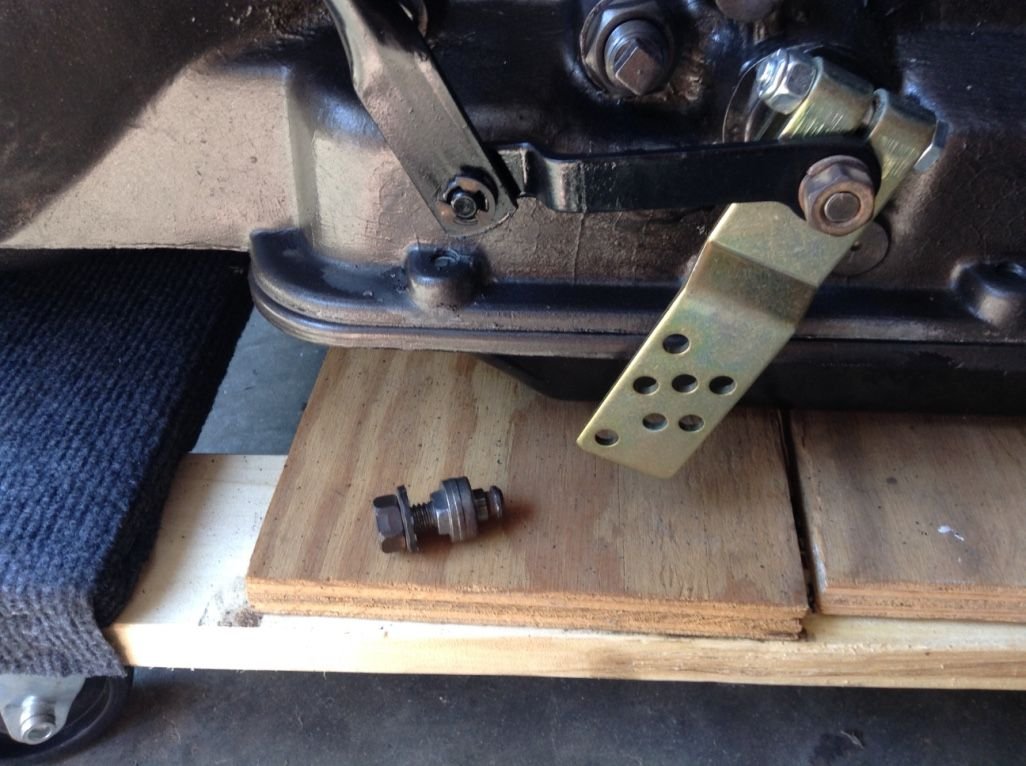

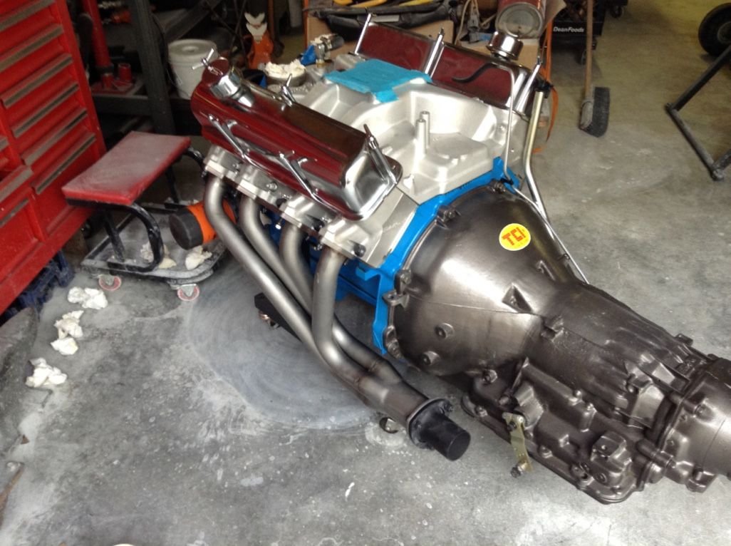

My setup is similar to yours except for the transmission linkage. The C6 pictured is from TCI so it has a different, more adjustable linkage system. Thus, I did not have the issue that you reported here.
Replacing the stock linkage is not easy in that one must remove the valve body. TCI replaces the stock shift linkage and provides a fully adjustable arm with a number of mounting holes for the stock pin that fits the shift column linkage. There is a delicate little clip there that I had to buy from Dennis Carpenter b/c I destroyed the one on the old transmission getting the pin out to mount on the new gear selector flange. Sorry I don't have pictures of the completed linkage install but I do recall that it was a rather tight fit even with the new, improved TCI shift linkage. I PM'd the part numbers to you so that you can check to see if your headers are the same as mine.

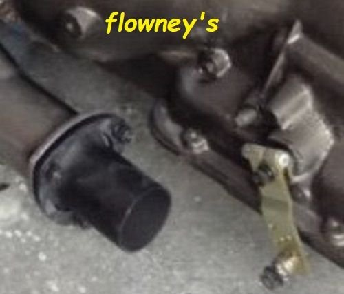

Here is a close-up of that TCI linkage:

Thanks Frank. So you're still using the kickdown linkage? I was just about to send you a PM about that. It looks like the shift lever is now inboard of the kickdown lever. Did you have to modify the linkage from the column to the the lever or the kickdown rod at all? I can purchase the TCI lever as a standalone part. Much cheaper than a new set of headers.
Yes, the TCI hardware enabled this configuration though I had to lengthen the stock kickdown arm to accommodate the higher intake manifold plus 1" carb spacer. On the transmission end all stock parts work as expected. On the carb end of it I used Edelbrock's kickdown linkage adapter.
The gear selector lever simply cinches down on the outer tube of this linkage (kickdown is inside that) so it has 360º to choose from. Switching to the TCI linkage will require careful planning and execution.

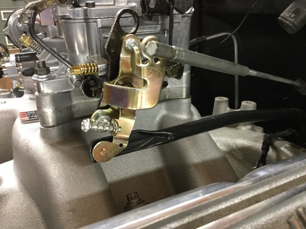

OK, thanks again Frank. Not sure if I'll need a kickdown adapter? My Quick Fuel carb came with a kickdown lever on it. I'll probably have to lengthen the arm though since I'm running the same manifold/spacer configuration that you are. Do you happen to have a picture of the setup on the carb?
Here is the carb with the Edelbrock FE adapter and linkage installed. You can see the accelerator and kickdown links attached. This product is probably specific to Edelbrock carbs.
