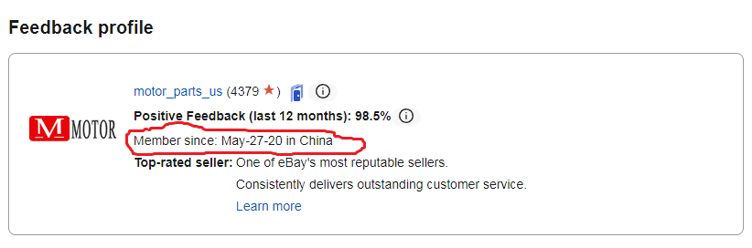

This is where they were purchased. I'm thinking Chinese crap with a Motorcraft Sticker on the box. I figured $80 was a little low but the other Chinese ones were around $30 so I thought these were Genuine. I was going to buy an oring kit but I'll take the loss and look for Genuine and toss these and take out the drivers side I just put in. Damn.
Edit: Even the white teflon o-ring looks like its damaged the black o-ring next to it.
I took a look at the Ebay listing you shared. If you scroll down to Brand it is listed as MOTOR Parts. There are a lot of references to OEM part numbers that I think are there to divert attention.

3 Year Warranty on this "Genuine Updated Stand Pipe & Dummy Plug Kit". (per EBay seller)
Good grief I really need to pay attention. lol Well lets see if he honors that warranty after the message I sent him. Thank you Mark for taking your time to look that up. Hopefully others will see this post and avoid this seller and the other 100 selling the same boxed parts.
