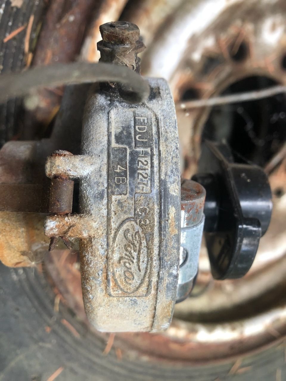

This was mine that took 1282
I think its the other numbers like 4BZ or C2 that clinched it for my selection. It looks to me its a difference in the rotor in my case.

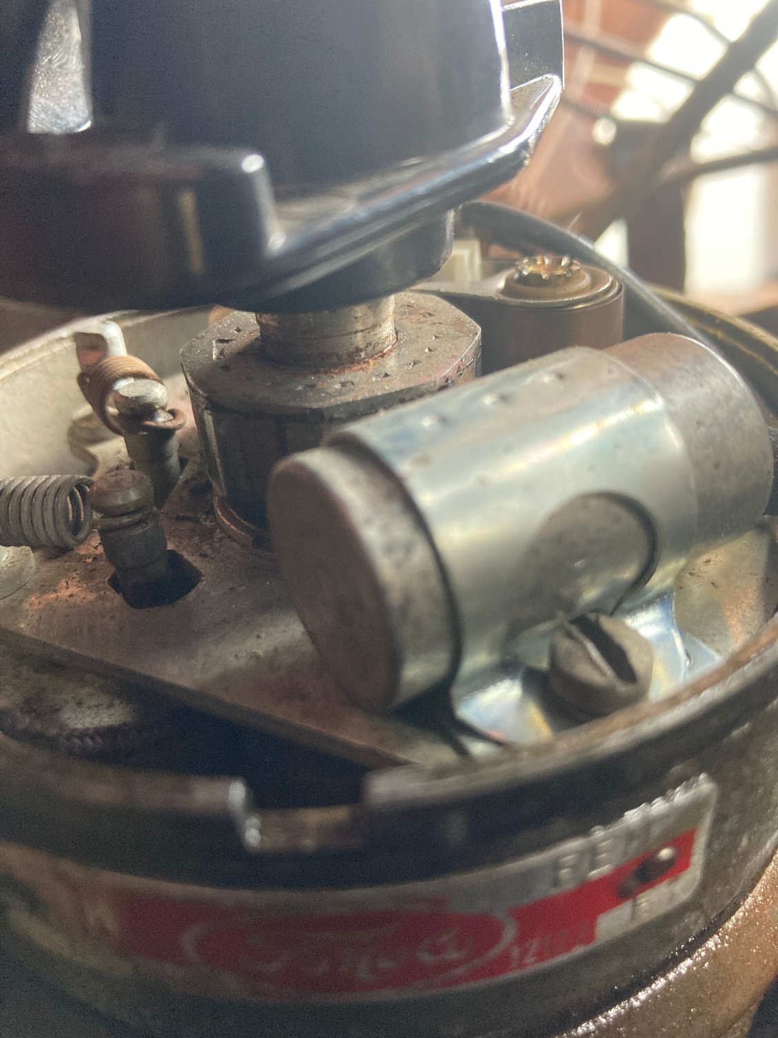

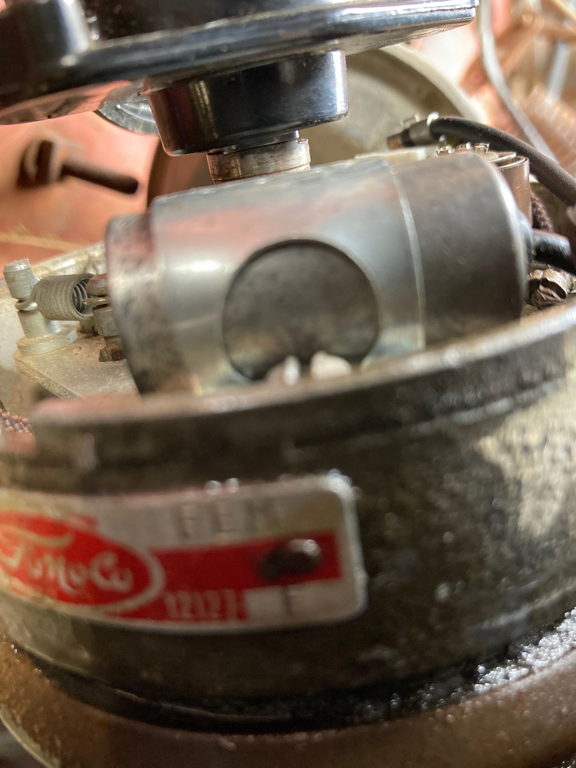

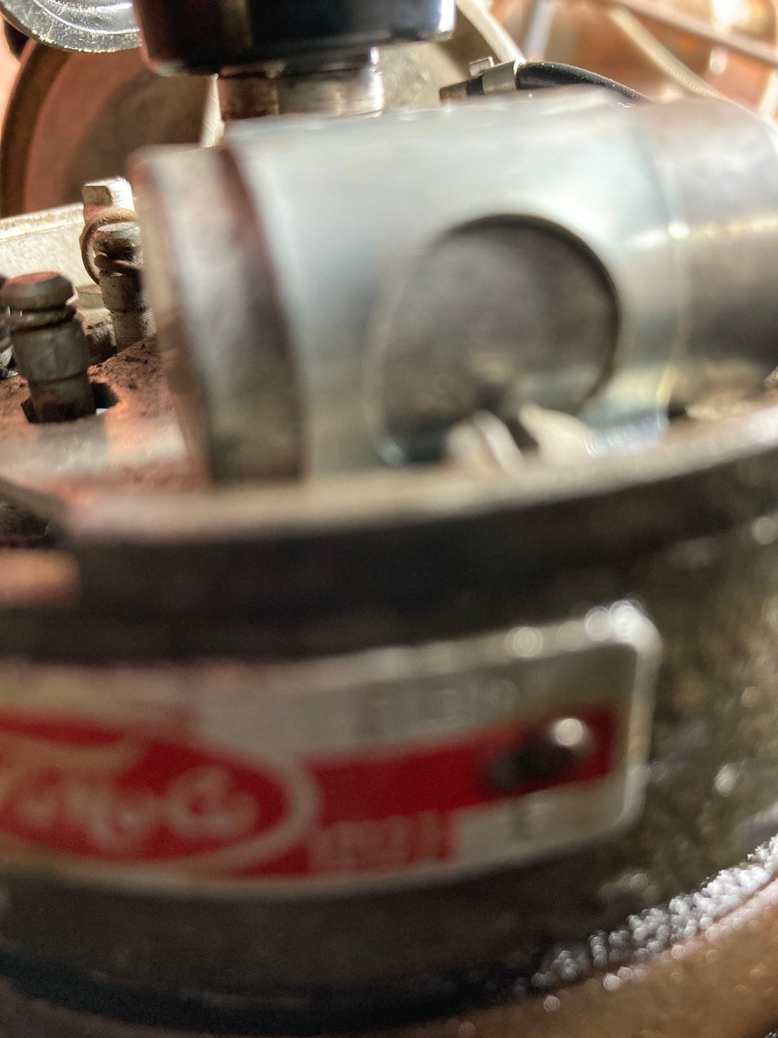

I know these pictures are horrible, but these are the best I could get, without taking the dizzy out.

That looks like the fat upside down rotor I had. Not the narrow small block looking one. Yeah those numbers are the whole show and unfortunately I cant see them in these pics.
try pulling the camera back and or rotate the dizzy for a different angle?

FEM
12127
F7
thats my best interpretation of the numbers as I can see it.
