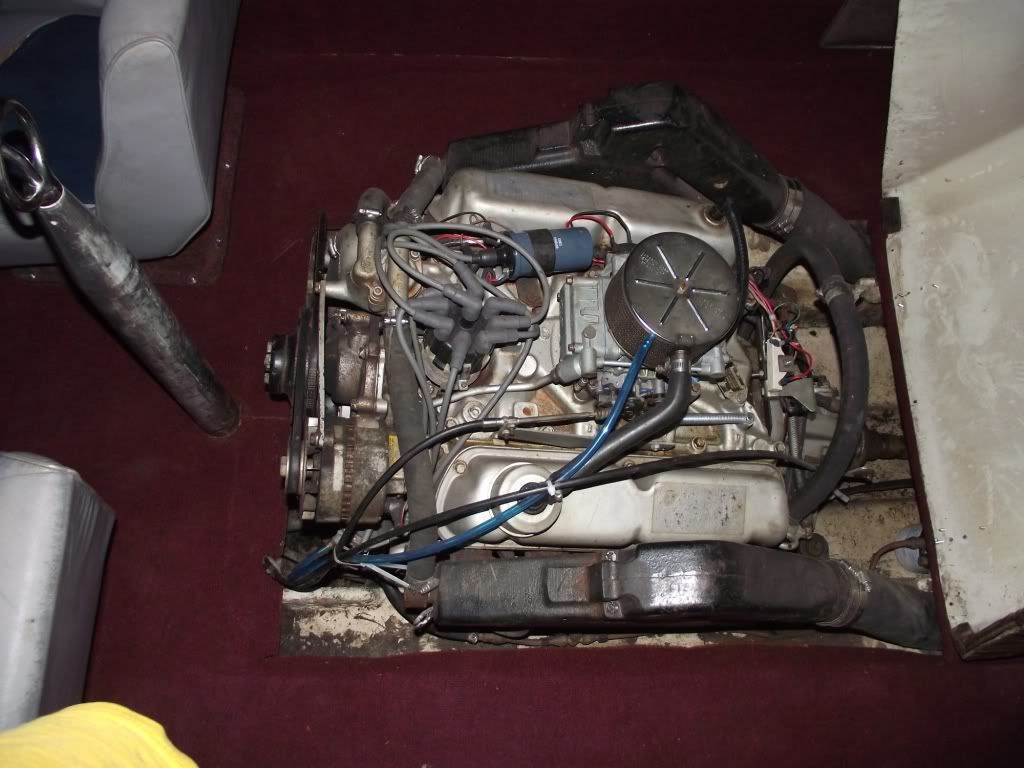

I've actually got a 351w in my boat and have been looking to do a basic tune up on it. It's an 86 model boat and has a 4BBL carb on it. The previous owner said he did something with the ignition but I can't remember what he did. I've tried the older model distributor caps from the 70's model 351's and they are a little too large and the rotor just spins in place. The distributor caps from the 80's model 351's are massively different.
Does anyone know of a distributor upgrade on these engines?
Here are some pictures of the engine. Obviously, it needs some cleaning up and I'm working on that. I'm 99% sure it's a 351w and the new valve covers I bought look like they'll fit but I haven't bolted them up yet.

Unfortunately your pictures don't show the distributor and cap very well. Try to get pictures of just these parts.

Yeah sorry. I was really just posting pictures in regards to the engine block itself. The base of the old distributor cap will fit inside the base of the new one so it's much too large. You're right, the rotor is what's actually spinning on the distributor shaft. Sorry if that was confusing. My distributor shaft is almost a half moon shape and the new one was circular with a slight notch at the top. This system doesn't appear to have points as I don't recall seeing the condenser, points, etc. but it still has a moving rotor so an electric system doesn't seem right either.

I can't be too sure from these fine pics, but that kinda looks like a mallory distributor
