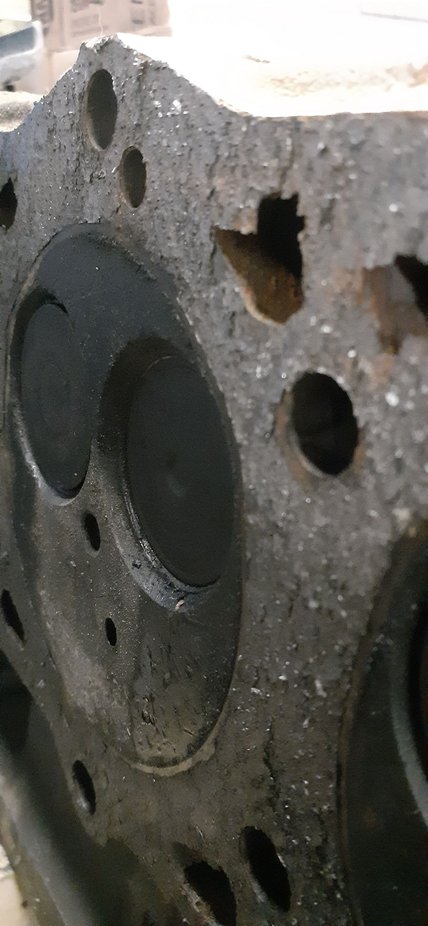

If you ever wonder how sunk a 7.3L valve can be in its seat and still run just fine......
All of the intakes were pretty equally shot.
