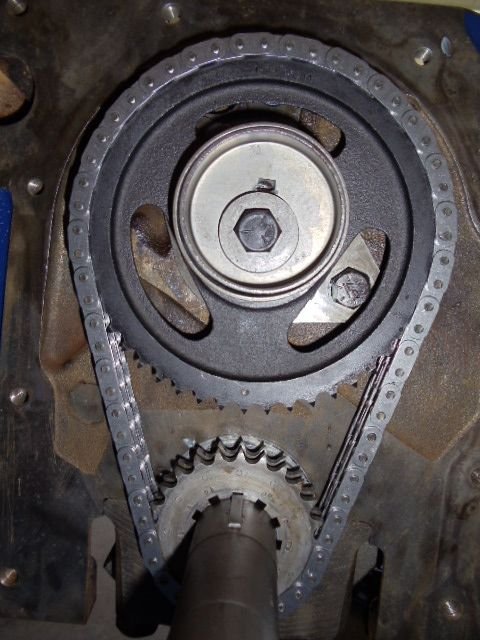

Originally Posted by 440 sixpack
It should be fine. But even a paper thin washer is another place for something to work lose, and this is why rod bolts don't use washers.
I would get a 1 piece, but that's just my opinion.
I was teetering on that. But my OCD gene just doesn't like that much friction, without oil squirting on it. I even considered that ball bearing eccentric. If I knew it'd get enough oil, I would have bought it, but it just looks like something that could wreck an engine in a hurry.
Old Feb 13, 2023 | 07:23 PM
mikeo0o0o0's Avatar
mikeo0o0o0
Joined: Apr 2009
Posts: 14,333
Likes: 247
From: Stanley, VA
I had the same problem with my 390 build, I fabricated a spacer from a fender washer.
