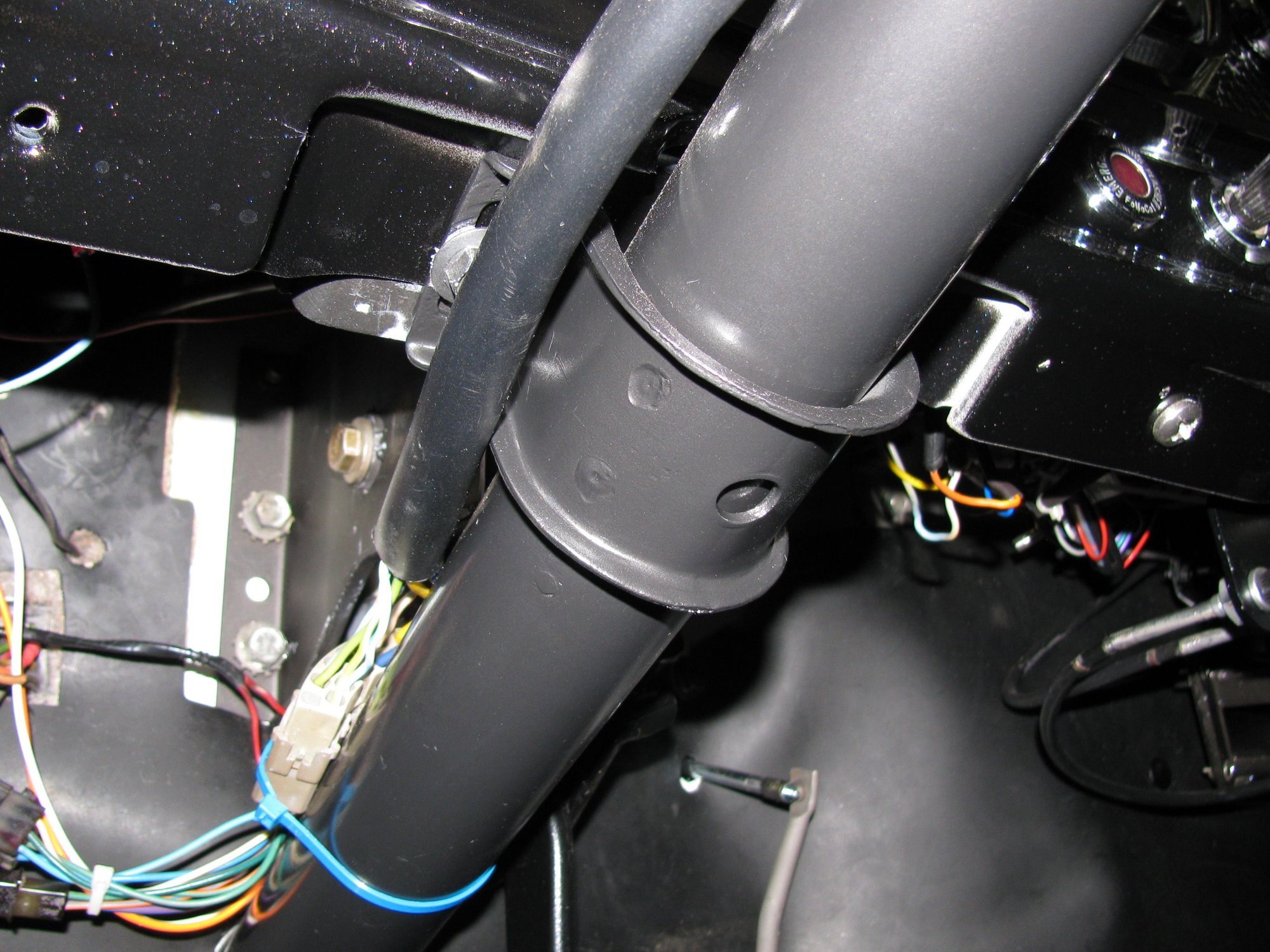

If you are going with the 400 you need the engine perches from the donor truck. The FE/I6 perches will set the engine too high. Your stock crossmember will work with the C6 but you will most likely have to drill a couple of new holes and have a new driveshaft made. Also, you may need the steering column and linkage from the 78 to match up to the C6. I swapped all the steering and suspension and disc brakes from a 79 to my 65. It is for the most part a bolt in.

When it comes time to install the column post up in the 61-66 forum several of us have done the swap and can help with the wiring etc. 1961 - 1966 F-100 & Larger F-Series Trucks - Ford Truck Enthusiasts Forums (ford-trucks.com)
To put a 78 column in a 61-66 you have to use the dash bracket from the original column. I believe these are re-popped now but I just drilled the old one off and swapped it.
