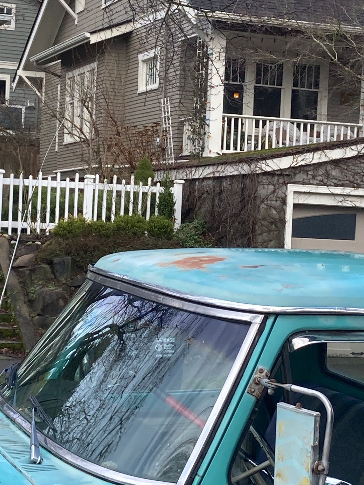

I'm bringing my 1968 F100 Ranger (which was mostly sitting on a farm for 20 years) that I bought this summer back to life. Got the camper off, remanufactured brake booster installed and carb rebuild. She's running great, but I'd like to touch up the paint in select places (see photo of the top of the cab.) The VIN plate says the paint color is 'Lunar Green.' WHERE DO YOU BUY paint that actually matches? I saw something about 2-stage paint and don't know what that is and suspect I don't have the equipment to apply it. I saw a thread here about getting it in a spray bottle from Napa but never heard any more about the results.
Any suggestions you have would be much appreciated. If you can help, please reply as if you're talking to someone who knows NOTHING about this because that is where I'm at.
