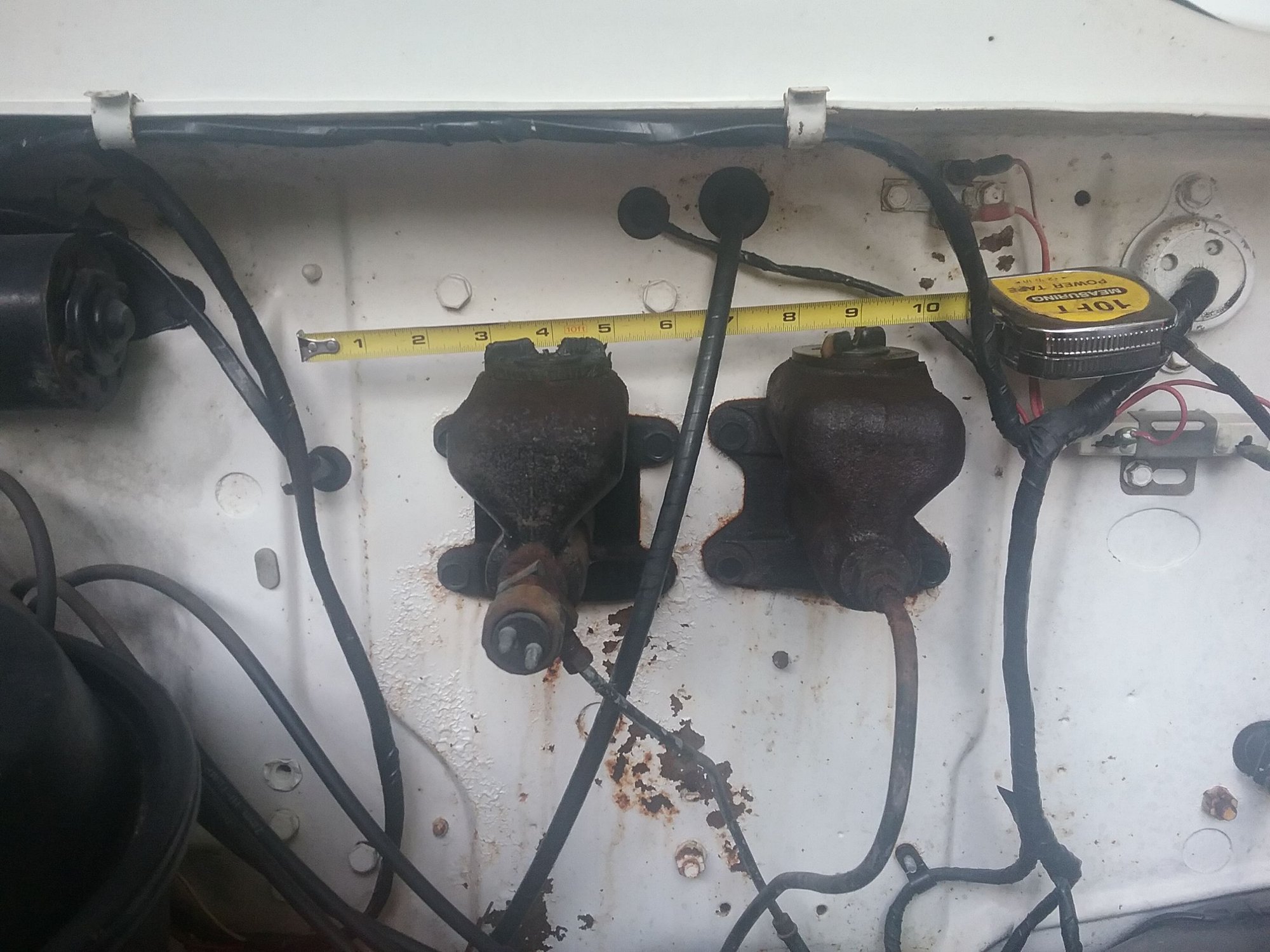

Went back and found old picture and looks like my Dad removed the one on mastercylinder. Should have wires on it right ?
Old Jan 31, 2023 | 09:44 AM
hiball3985's Avatar
hiball3985
Joined: Mar 2005
Posts: 3,771
Likes: 80
From: tujunga, calif
No wires on the master cylinder switch should be correct since your switch is on the pedal. The pedal switch should be using the same wires that were on the master originally.
