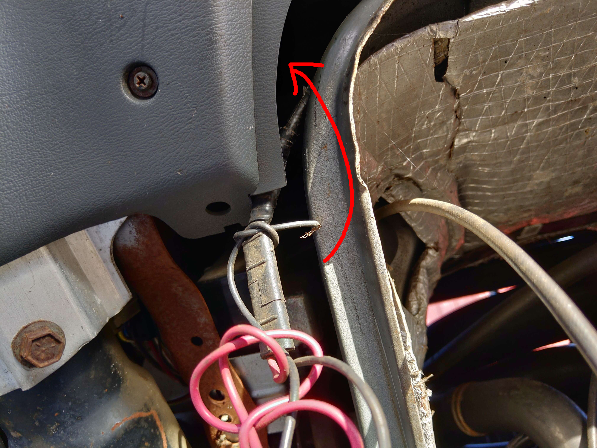

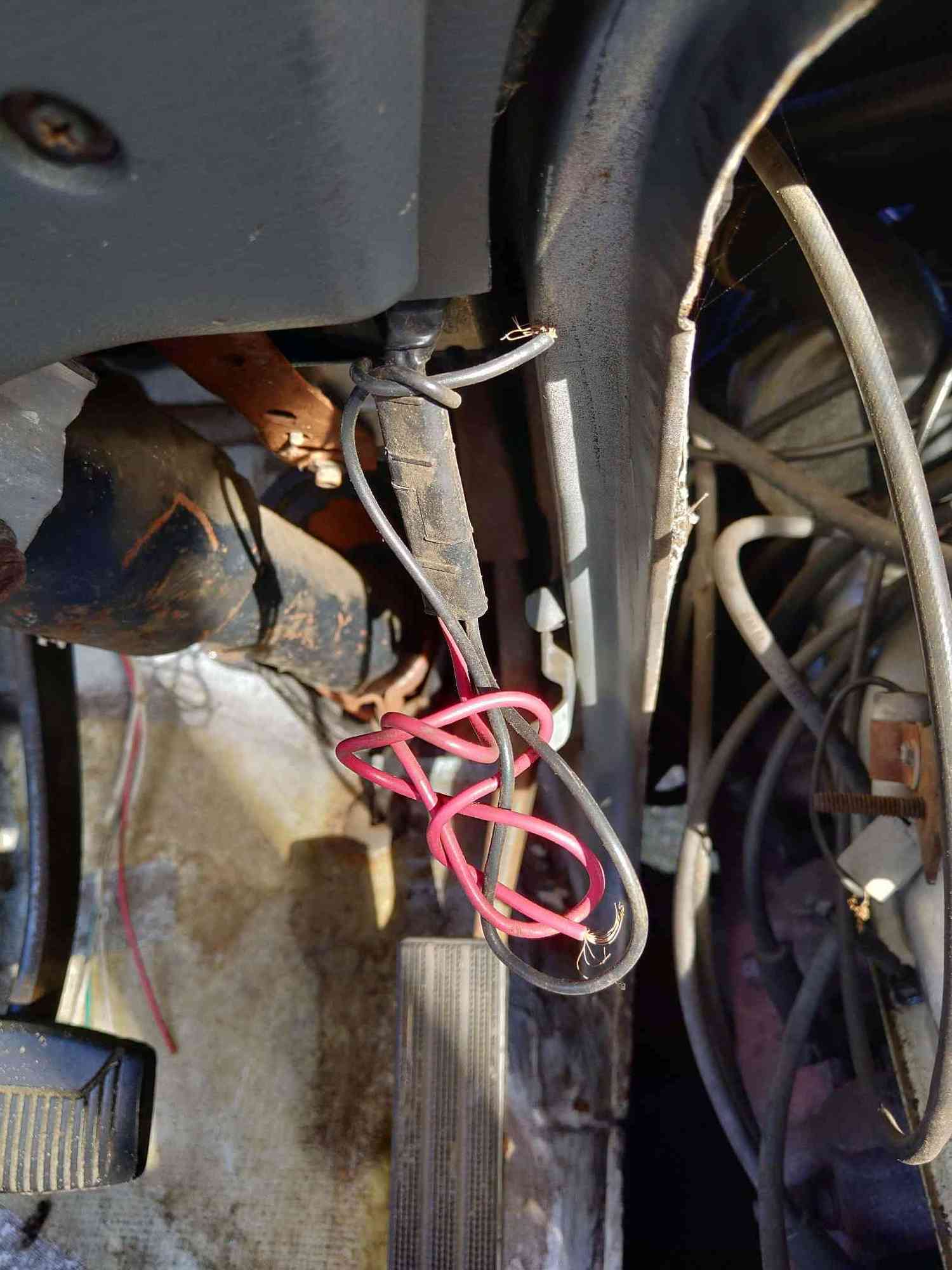

I found these stuffed underneath the dash near the steering column. No clue what they are or how long they've been like this for, but I do know I somehow haven't seen it until now. Could this be the culprit? What are these for? They look like they've definitely been cut by someone and I know it wasn't me.
Where it's located
Up close photo
I pulled it from up there
Old Jan 30, 2023 | 03:18 PM
Econowner's Avatar
Econowner
Joined: Dec 2020
Posts: 26
Alright, that was it. These little guys were causing all those problems. I just untangled them and put them out in the open, making sure they aren't touching anything, and suddenly everything works again. The headlights, however, still don't turn on. These must be related to that issue. I don't see where they were cut from. Only people who could've possibly done this were the mechanics I had change a transmission fluid line.
