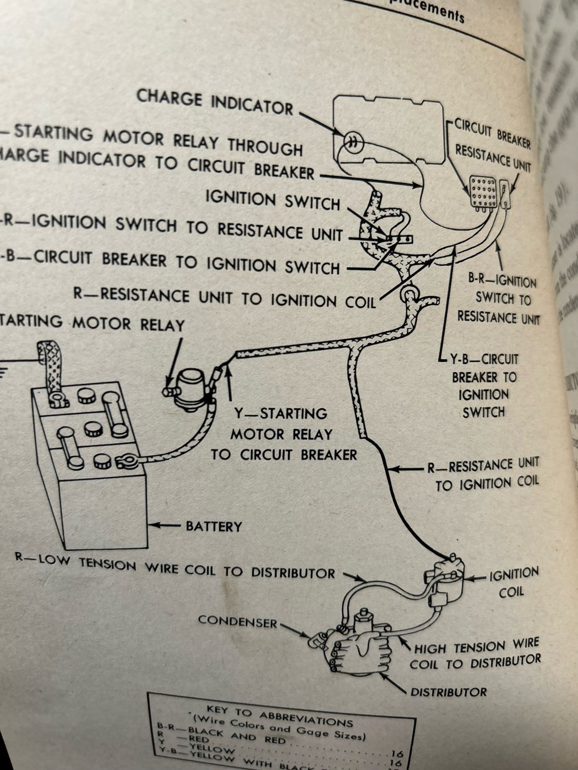

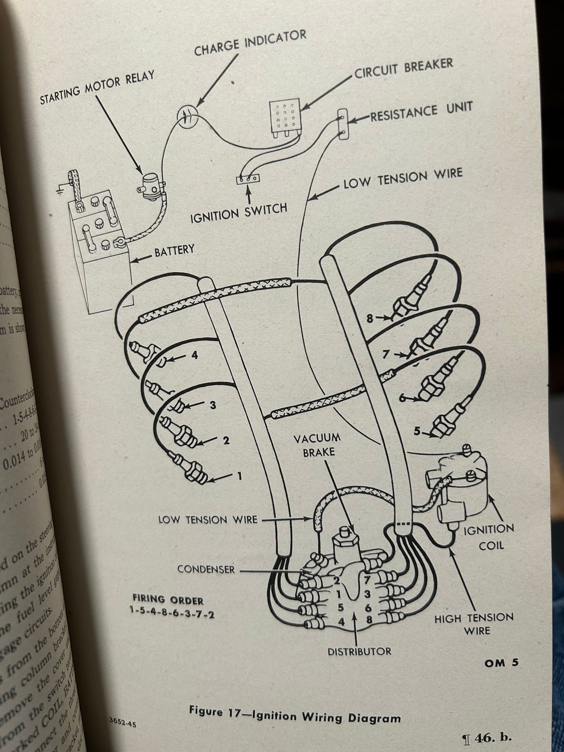

My flathead the power goes to the distributor then goes to the coil then grounds to the block. I like to have a wiring Symantec of the motor

Power should go to the coil, then to the dist, you should be able to google what you're needing.
