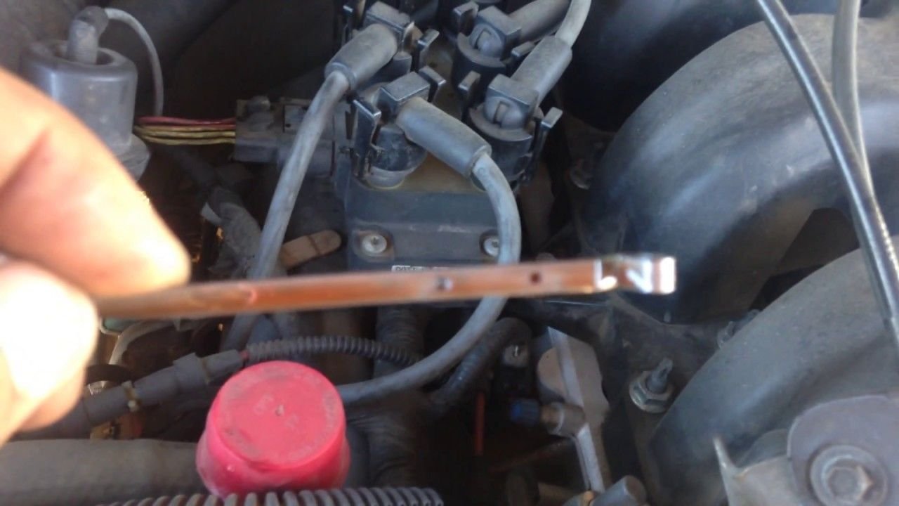

When Cold the fluid level on the dipstick for the transmission is about half inch past the last mark.
How is this dipstick read? Little confusing

You need to check the level with the engine running, In park.

If you read the fluid level with the trans cold and the engine off, all that you can determine is that there is fluid in there. You could be a gallon overfilled, or even a gallon low. There is no way to tell.
The trans fluid MUST be read with the trans warmed up, engine idling, and the shifter in park.
