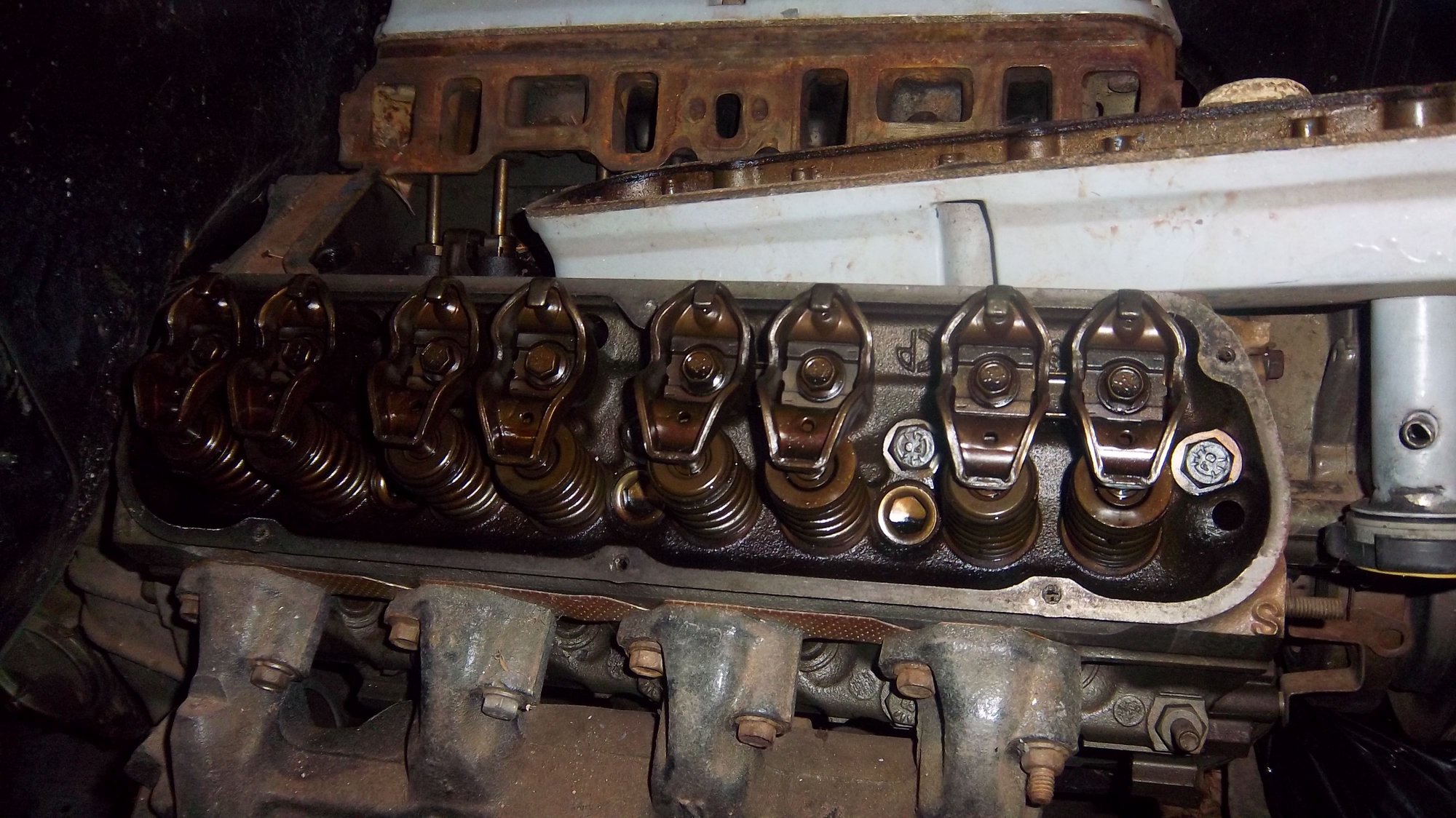

Scndsin---thanks for confirmation of the year, still wondering about the early or late mfg in 1987. I failed before to add pics, finally got it this time. Or would pics of the block nubers underneath be what you wanted?
the project
still oil on the rockers
looks good enough to me

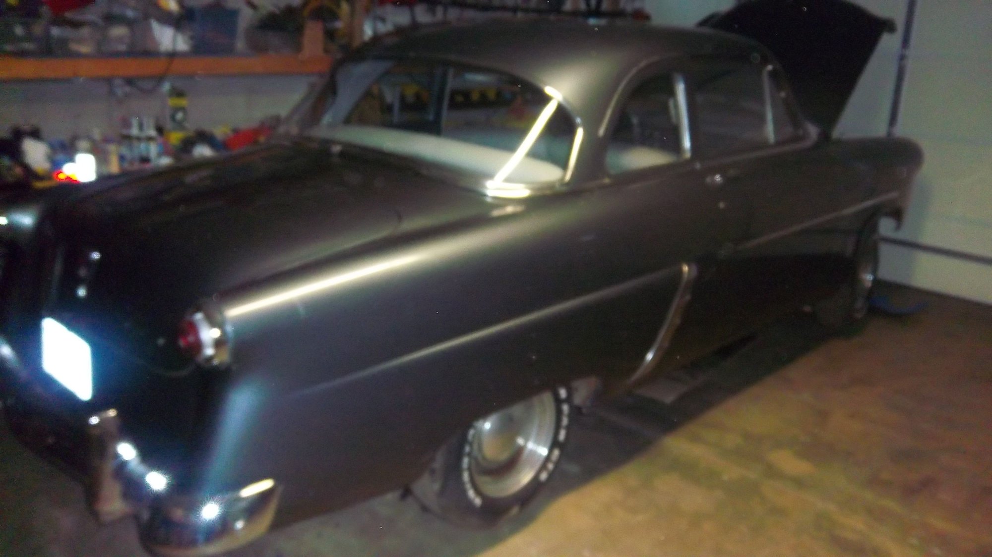

the project car w/ 302 & C4 (I think so far...)
the project

Ford used the same engine castings for many years epecially with these Windsor family engines, that same block could be found in trucks right up until Y2K. I also see a couple other things... the flat top pistons and the capitol S cast into the outer corner of the cylinder head. That means those are E6SE cylinder heads which were originally designed for the '86 Mustang, the casting numbers for these are found on the underside of one of the central intake ports. These heads are easily the worst SBF head ever produced with a heavily shrowded valves and restrictive ports, if you ever want to see more that about 200hp out of this thing they should go away. The matching E7TE head or one of the GT40 castings(F1ZE, F3ZE) are much better.
This oddball combo of parts was used in the crown vic for a few years before '92 and in trucks between '92 & 93.
